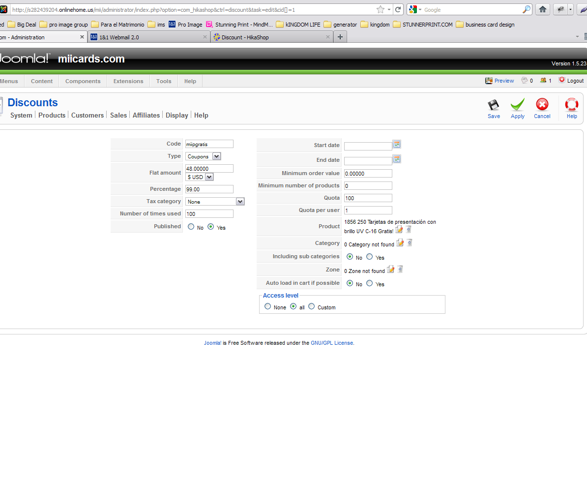

14 years 11 months ago #25875

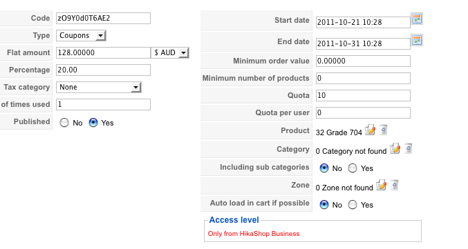

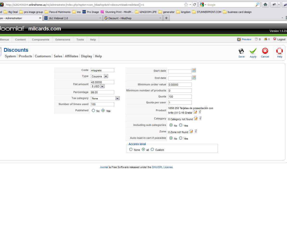

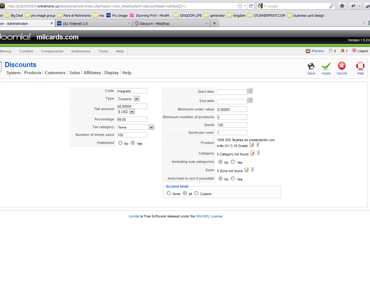

Hi Nic, Looks pretty simple but I have problems with the coupons , I read the instructions and create a coupon to be apply to a product, then I enter the code but is not working , do you have any other manual for this , I also compare to the settings in your demo site but still not working , any help will be great.
  • Posts: 86179
  • Thank you received: 14217
14 years 11 months ago #25883
Could you do a screenshot of the configuration of your coupon so that we can see what you did ?
What do you mean by "it is not working" ? Do you get an error message when you enter the coupon on the checkout ?
  • Posts: 188
14 years 11 months ago #25887
thnaks nIc her is
  • Posts: 86179
14 years 11 months ago #25888
The number of times used and the quota is the same in your coupon.
That means that it can't be used anymore as the quota is exhausted.
  • Posts: 188
14 years 11 months ago #25889
Thanks so much, I got it.

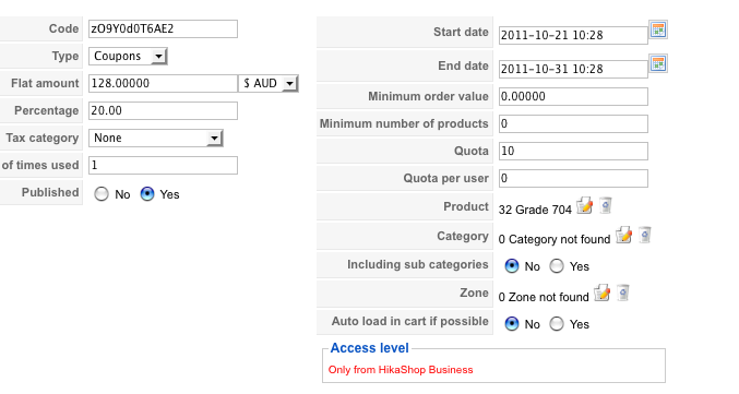

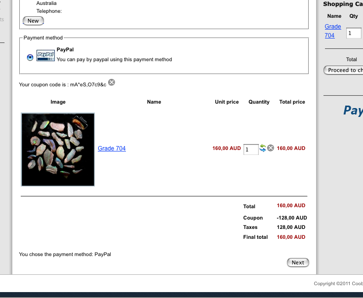

  • Posts: 19

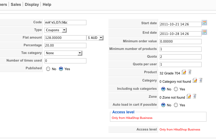

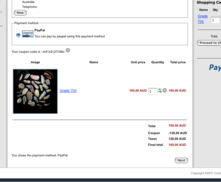

14 years 10 months ago #27952

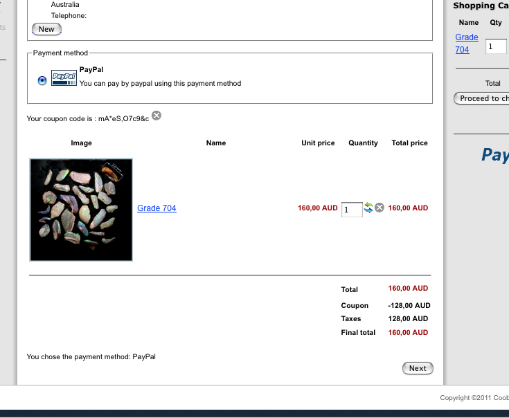

Nicolas,
I am trying to see up the discount coupon facility, but it keeps adding the discounted amount back on as a tax, please see attachment.
thanks
David
  • Posts: 86179
14 years 10 months ago #27974
Could you do a screenshot of how you configured your coupon ?
  • Posts: 19
14 years 10 months ago #27993
hello,
here's a screen shot of the discount configuration page.
thanks
David
  • Posts: 86179
14 years 10 months ago #27994
Thank you. We were able to reproduce the problem on our end and fix it.
Please download again the install package from our website and install it on yours over your current version. That should fix the problem for you too.
  • Posts: 19
14 years 10 months ago #27996
thanks for that, nice to know that for once it wasn't my fault :)

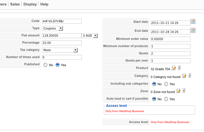

  • Posts: 19
14 years 10 months ago #28000
Nicolas,
I still can't get the discount coupon to work, here is my setup page.
david

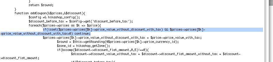

  • Posts: 86179
14 years 10 months ago #28003

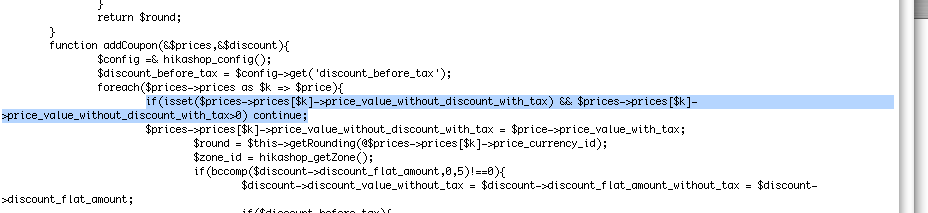

Please make sure that you have the line:
if(isset($prices->prices[$k]->price_value_without_discount_with_tax) && $prices->prices[$k]->price_value_without_discount_with_tax>0) continue;
in the file administrator/components/com_hikashop/classes/currency.php
If you don't, it means that the file wasn't updated.
Do you have the same behavior as before ?
  • Posts: 19
14 years 10 months ago #28009
yes it's there (see attachment) no I didn't have the problem before.
Before it just added the discount back on as a tax.
David
  • Posts: 86179
14 years 10 months ago #28013
What problem do you have? The screenshot you posted is the same as before. Maybe you didn't post the correct one ?

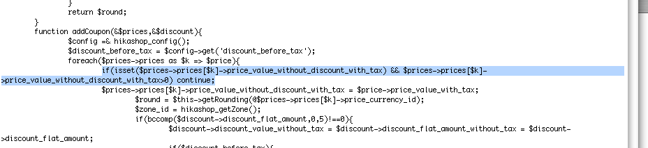

  • Posts: 19
14 years 10 months ago #28014
I can not get the coupon discount to work and you asked me if I had this line
I thought I had sent you a screen shot of my currency.php file, apparently I didn't so here it is showing the line.
  • Posts: 86179
14 years 10 months ago #28015
We cannot reproduce the problem any more since the modification we made solved it on our end. Could you give a link to your website so that we can see the problem ?
