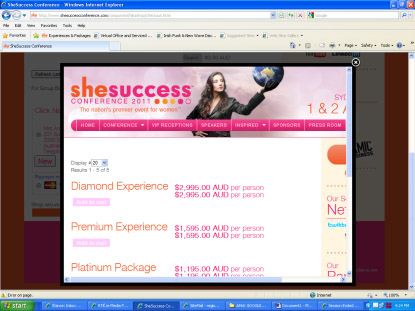

Tried it doesn't work. The multi-grade is the only one that shows now however. Something my client is getting that I don't get is the popup window doesn't go away. It loads a page in the window instead. Here are their comments:
logged in using my details and attempted to purchase a Silver ticket.
I clicked on "New" and filled in the popup form.
When I clicked on "Submit" I got the attached page showing the double entries for all the packages. See attached screen grab.
Next I cleared the cart and went back to the Experiences & Packages page.
Clicked on Gold Add to cart
This took me to the page you have changed.
This time I clicked on Purchase Now (as the address details are there many people might select this option)
This took me to the same double entries page - screen grab.
Because I do not have the new Internet Explorer 8 I can't see if there is a conflict here.
I think keeping everything on the checkout page rather than using this pop up may be a better solution. It seems to be causing a lot of problems.

Sorry, for my statement. It is great to hear that in the future this may be added. Your code worked like a charm. Funny thing was, when I put in that code an refreshed the page, the page with the double amounts that my client was seeing in the pop up window showed up on the refreshed page. Which is weird because that page doesn't really exist anymore. I changed it. Oh well, I will ask my client to see if it now works properly. Thanks again.
