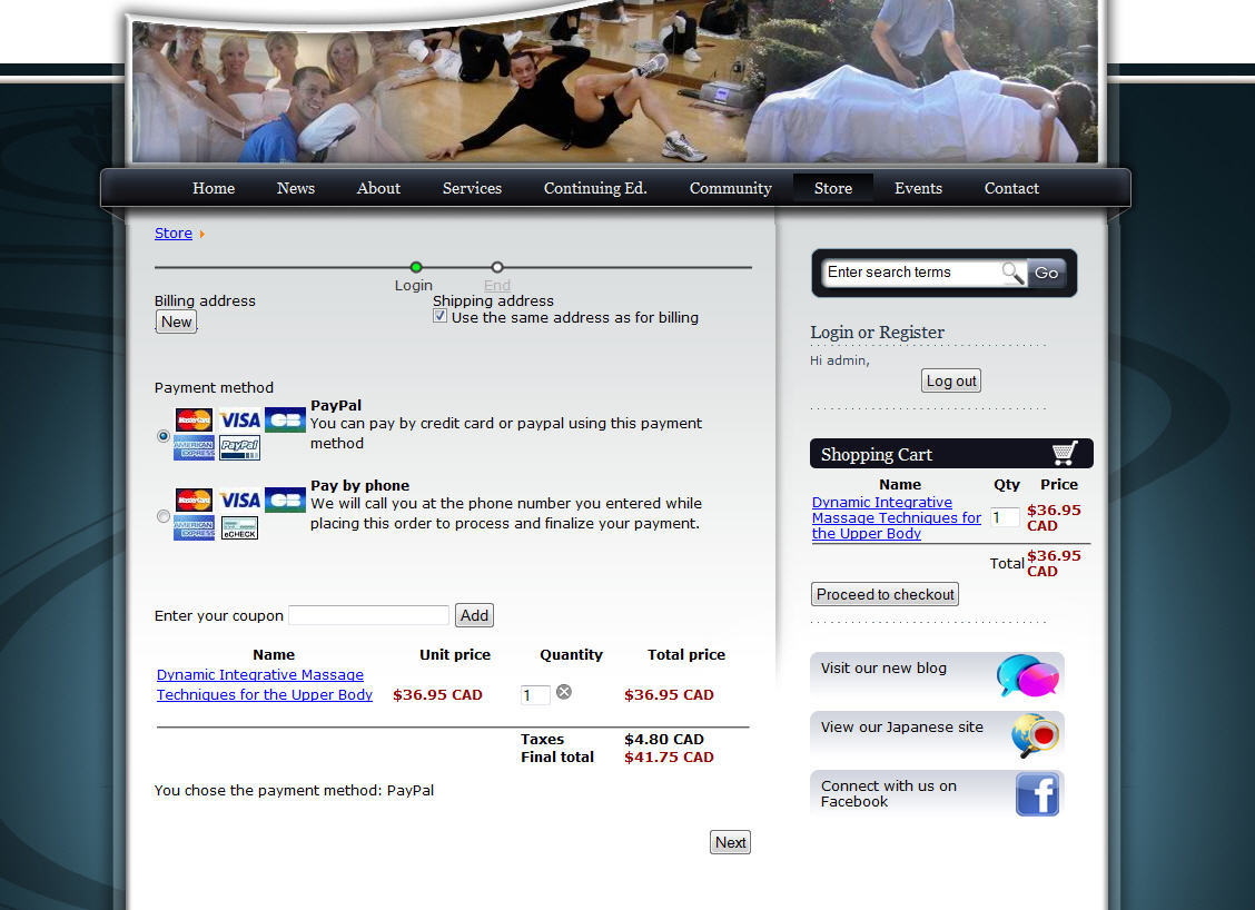

  • Posts: 4
15 years 8 months ago #2622
For example I go to the link I posted above, I add a dvd to the shopping cart, I click "proceed to checkout", I login, on the checkout page I see "billing address" under that a "new" button, on the other side is "Shipping address" and "Use the same address as for billing." Under that is the details about my order. Then at the bottom of all this is a button that says "next".
If I hit the "next" button this page just reloads. I keep hitting it, the page keeps reloading and I have no idea why I'm not taken to the next step. Shouldn't there be an error message at this stage saying that my checkout can't finish because I haven't entered in a billing address?
I added an image of what I see after hitting the next button, am I missing something?
Last edit: 15 years 8 months ago by ncreatives. Reason: added screen cap
  • Posts: 86080
  • Thank you received: 14188
15 years 8 months ago #2629
Please try to change the code
if(empty($billing)){
			return false;
to
			$app =& JFactory::getApplication();
			$app->enqueueMessage( JText::_('CREATE_OR_SELECT_ADDRESS') );
			return false;
in the function after_address of the file components/com_hikashop/controllers/checkout.php near line 630 and try again.

  • Posts: 13
15 years 8 months ago #2645
Thanks for this fix Nicolas. I found the code to modify at line 475 of checkout.php, in the function after_address().
Worked a treat :)
  • Posts: 4
15 years 8 months ago #2663
Yay it works! Thank you very much!!! :cheer:
