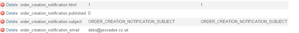

I don't seem to have that line so I've added it but it still send the customer the notification email. I've attached a screenshot of what I have in that section. Should I be changing the .html one to 0?
Many thanks

  • Posts: 85796
  • Thank you received: 14089
14 years 9 months ago #26367
No, the html option is for something else.
That should do it.
  • Posts: 6
14 years 9 months ago #26422
It's still sending the order created email to the customer. Is there anyway to just get rid of this order created notifications completely. Is there something else I need to change?

  • Posts: 85796
14 years 9 months ago #26424
There is no other solution that the two mentioned which doesn't involved modifying the code of hikashop directly. You could edit the file administrator/components/com_hikashop/classes/order.php and remove the send of the email in the save function.
