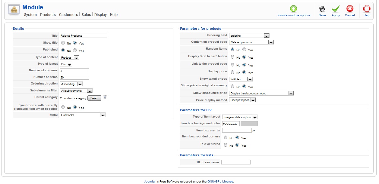

I created a new content module entitled Related Products, left it unpublished, synchronized it with current product, set it to show under the product, set two products related to each other in my products, but nothing shows! Please help.
  • Posts: 86099
  • Thank you received: 14201
15 years 7 months ago #5195
Which version of HikaShop are you using ?
Could you post the URL of the product page where you have related product ?
Could you also post a screenshot of your related module configuration ?
  • Posts: 13
15 years 7 months ago #5196
I am using the Starter version. The first three books listed under the Books (Top menu) are related items and I would like them to show on each of the respective pages.
Here is the url:
www.urbansitedesigns.com/books/sex-and-the-bible
  • Posts: 13
15 years 7 months ago #5198
Here is the screenshot.
  • Posts: 86099
15 years 7 months ago #5210
The options sound ok.
Could you make sure that your products are published and that your module is published in the option "modules under the product page".

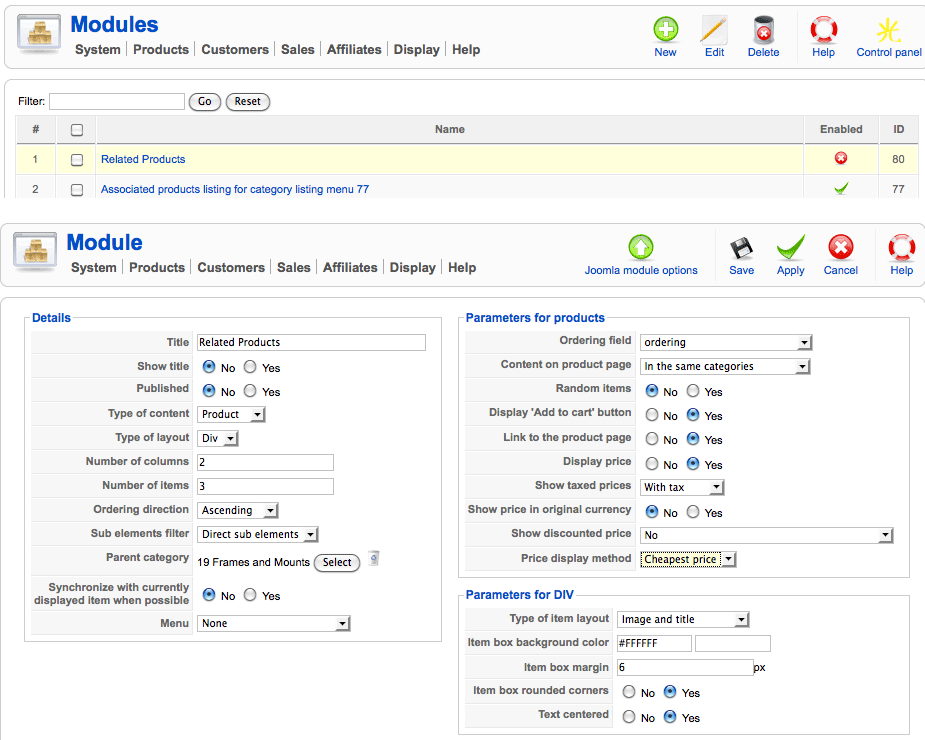

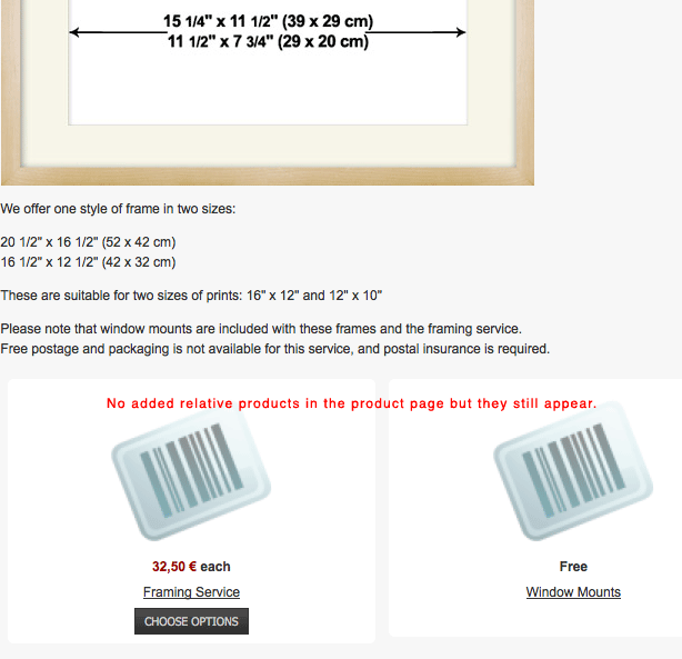

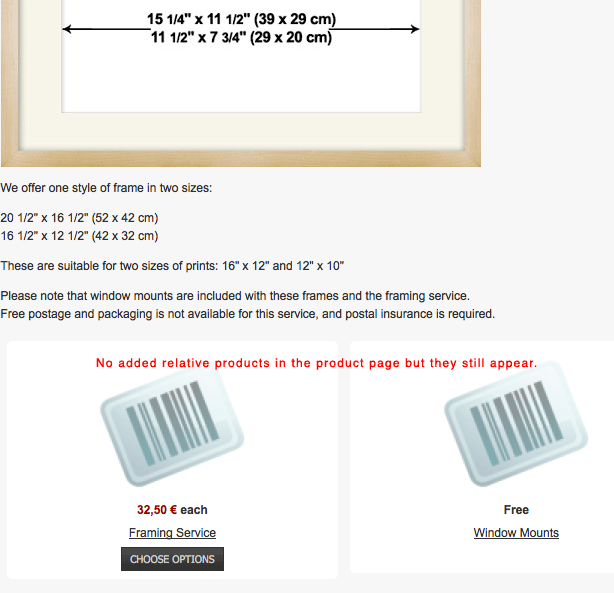

I want only two related products to appear below all print products, they are two kinds of framing services. At present this is what I have but the two related products show up on product pages where I have NOT added related products in the product edit page.
This includes the two frame service products too, which is obviously wrong to display the same product as a related product.
Therefore something is amiss somewhere. Here's some more screen shots of the settings for you:

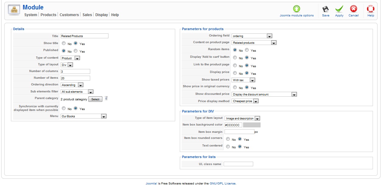

  • Posts: 87
15 years 6 months ago #9262
Module settings:

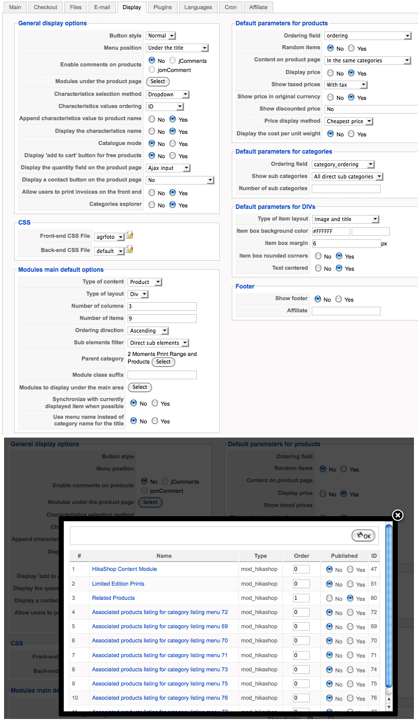

  • Posts: 87
15 years 6 months ago #9263
Config --> Display settings:
The "modules main default options" have no "module display..." selected.
