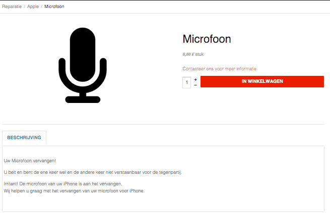

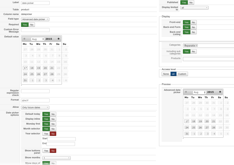

I red a lot about this issue, but there is something i don't get.
I created a date picker like:
but now i want to add this picker to the products of the category "reparatie".
What do you i have to do to see the date picker in:
extra info:
Most recent version of hikashop business (rsgsm.nl)
Last edit: 11 years 4 weeks ago by Ziggy.
  • Posts: 86176
  • Thank you received: 14211
11 years 4 weeks ago #211579
You created a custom field of the table "product" and that will display the field when you edit your product.
If you want to display the field when the customer displays the product page, you instead need to create a custom field of the table "item" via the menu Display>Custom fields.
The following user(s) said Thank You: Ziggy

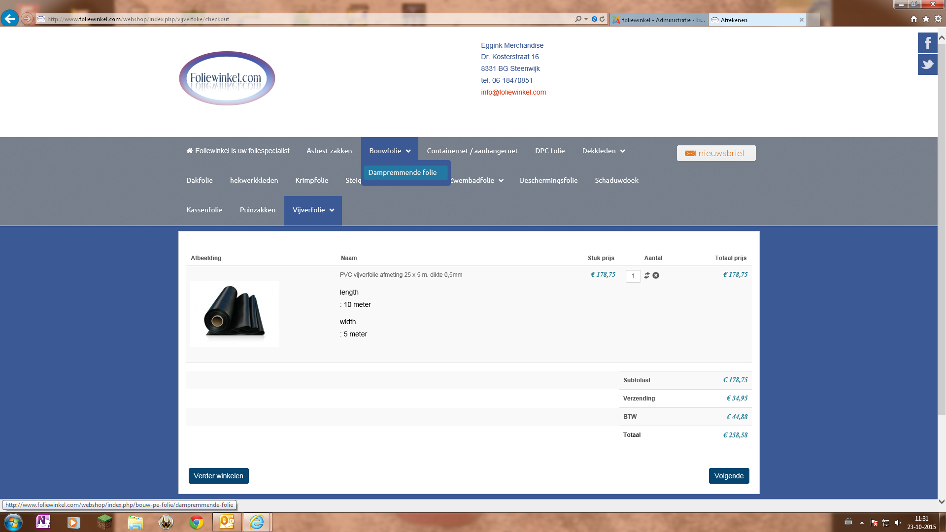

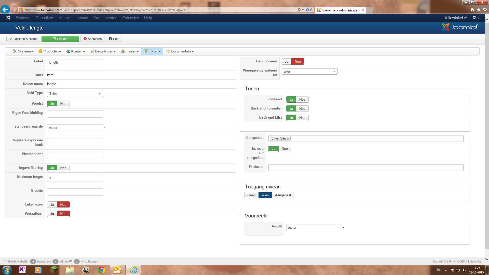

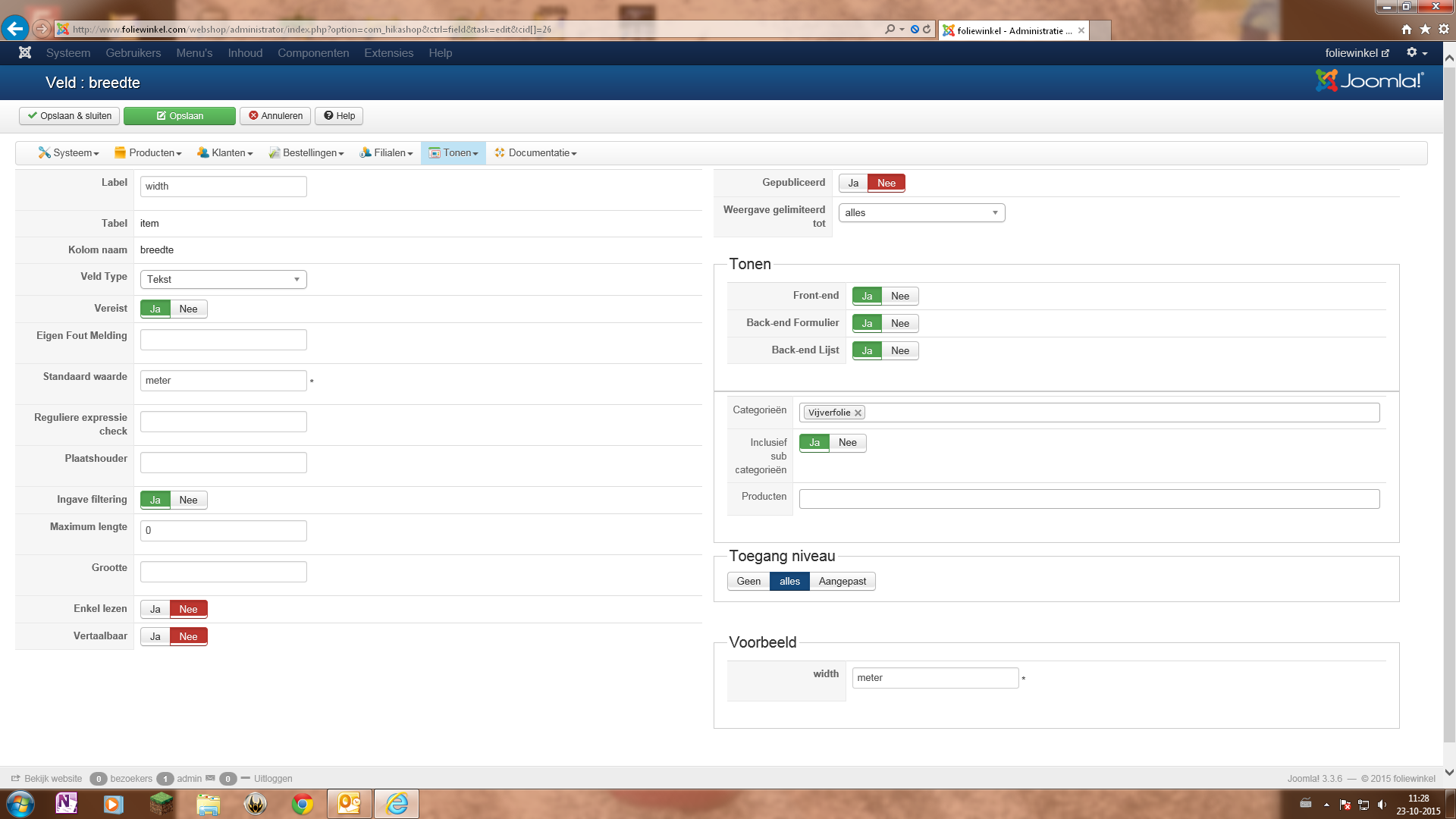

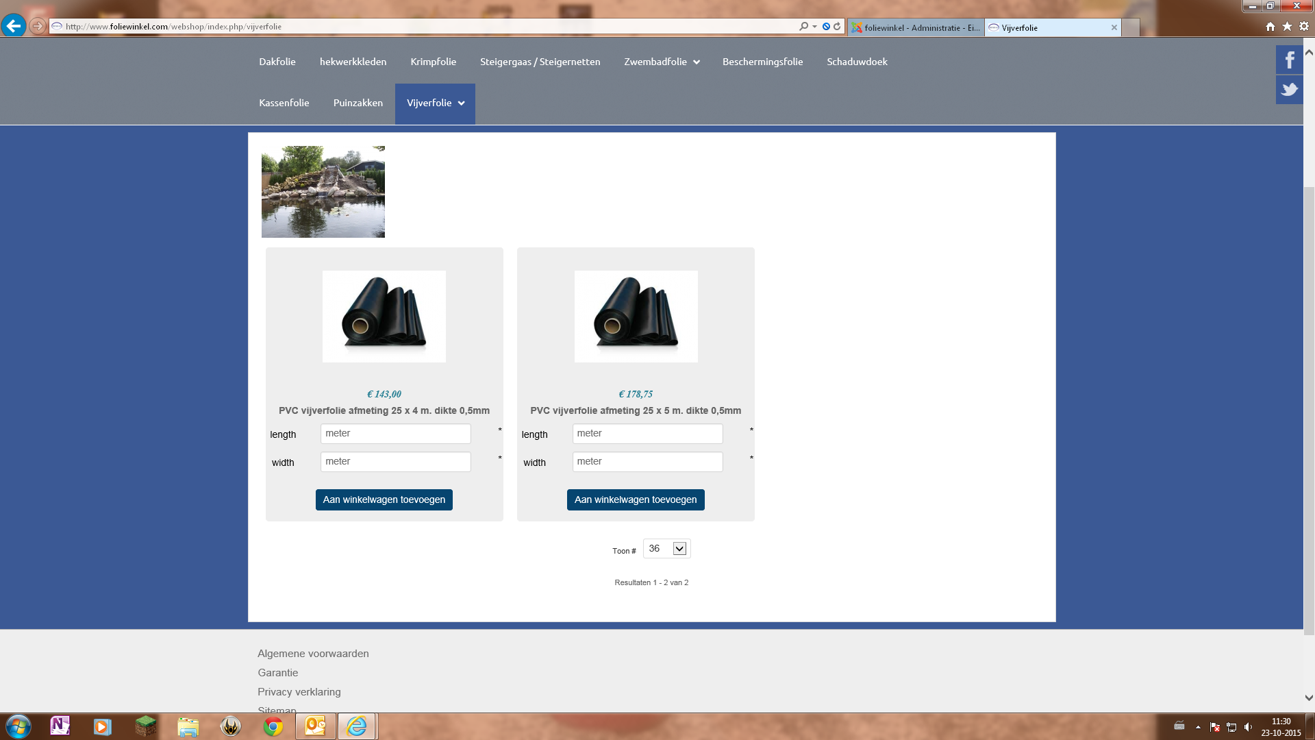

  • Posts: 26
10 years 10 months ago #218180
I installed the plugin and is published.
I make the item fields and they are published.
Only what's not working is calculating the price after i push the add to cart button.
I send some printscreens to clarify.
Last edit: 10 years 10 months ago by Joeri. Reason: vergot
10 years 10 months ago #218475
The issue come from the "Kolom Naam", there it must be "width" and "length" and not "breedte" and "lengte".
That's why it is not working as expected.
If you want to keep these Kolom naam, so you can edit the plugin directly and replace the occurrences of "width" and "length".
The following user(s) said Thank You: Joeri

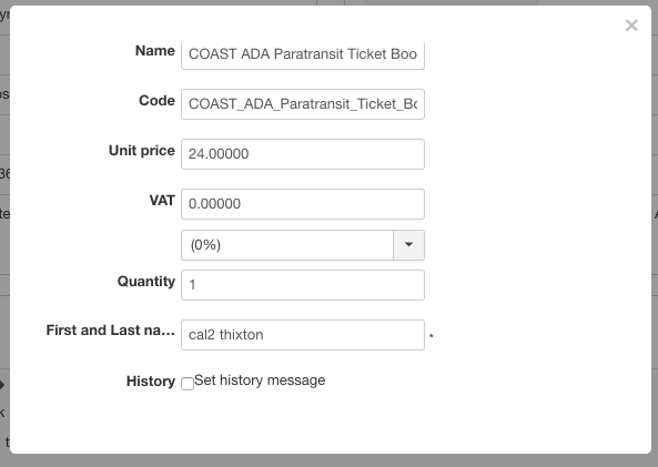

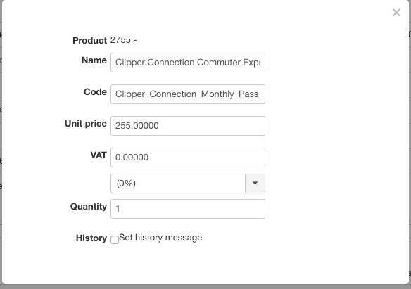

We have been using Hikashop for several years now and upgraded to 3.1.1 business this summer and it broke part of our site.
We sell 3 types of bus tickets.
1) Two have variants with the year, month and route along with a custom field asking for the card holder's name to put on the bus card.
2) The third has no variants and only asks for the card holder's name (it is just a book of tickets which can be used at any time).
Everything worked fine after the upgrade until we noticed that the card holder's name info was not being stored on the first two types of tickets (#1 which also ask for the year, month and route), while the card holder's name is saved on the third type (#2 the book) even though for all three, the card holder's name is required when adding the product to the cart.
All 3 products look to be setup the same and we cannot see any category or permission differences between them.
Additionally, when drilling down into an order, for #1 types, the field for the card holder's name is missing, while on #2, it is there (see attached).
This only broke since the upgrade to business. Any ideas? Thx.
  • Posts: 86176
9 years 1 week ago #277575
First, please update to HikaShop 3.2.0.
It contains a few patches for the custom fields.
Also, edit your custom fields and make sure that the display settings of the custom fields are correct.
