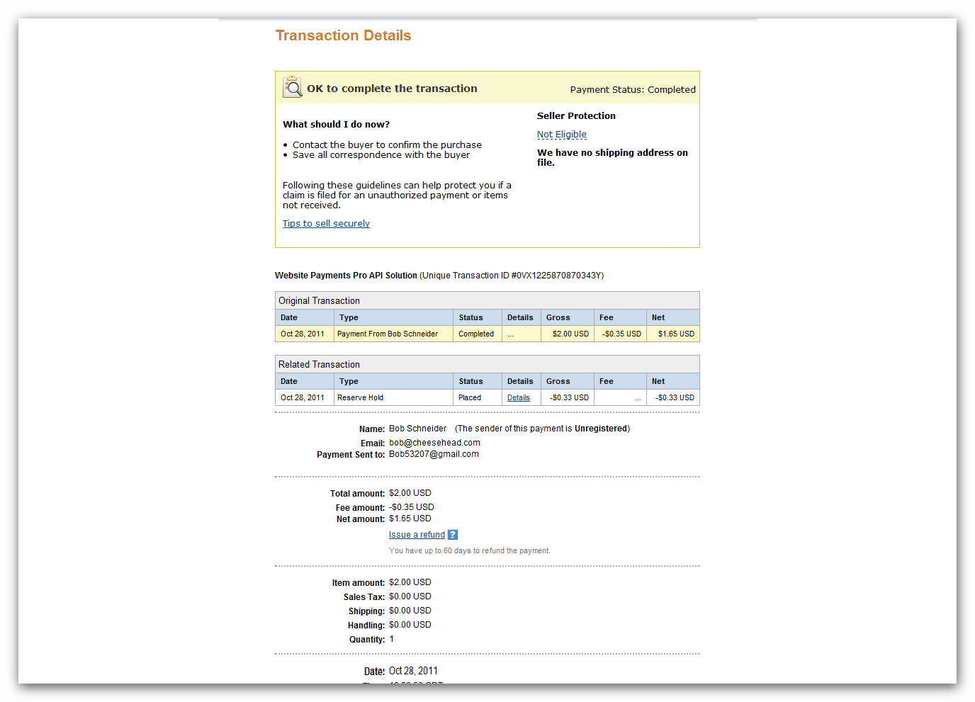

14 years 10 months ago #28811

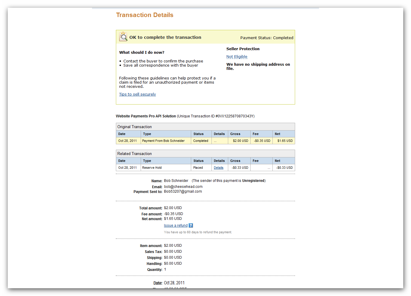

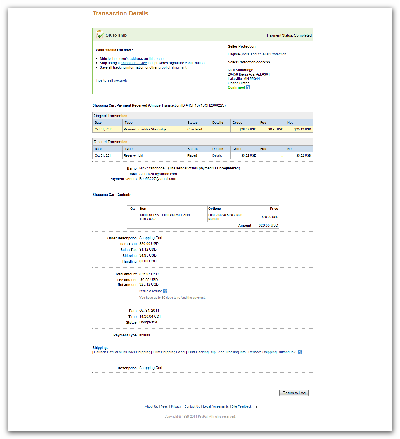

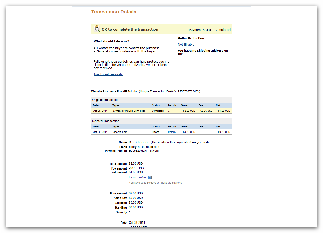

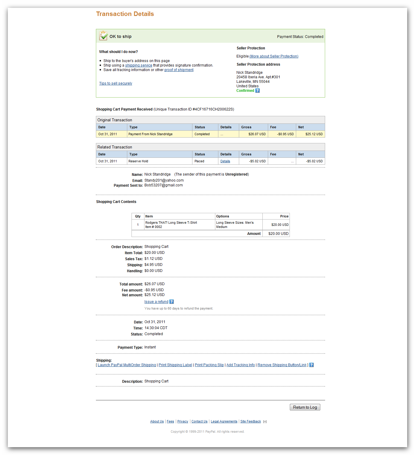

Currently, using PayPal Standard buttons, I receive orders with all the info I need to fulfill. I get what the customer ordered and I get his/her shipping info which I can then easily print a USPS shipping label - all within PayPal (see attached order).
Testing your PayPal Pro plugin, all I get is the amount paid and customer name (see attached).

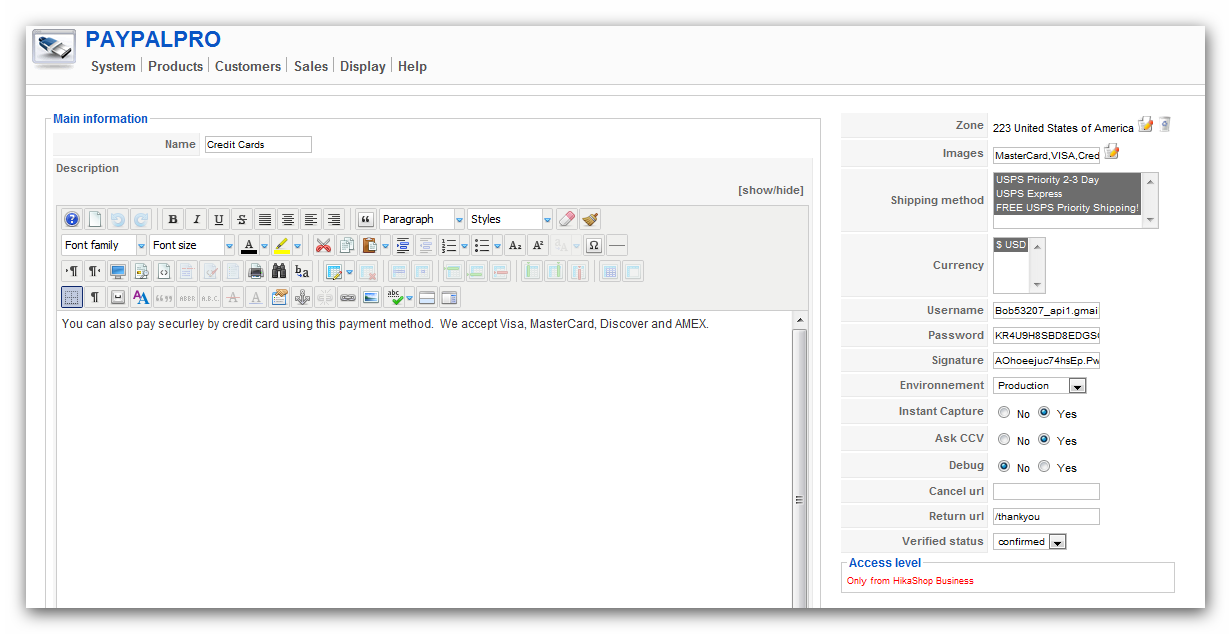

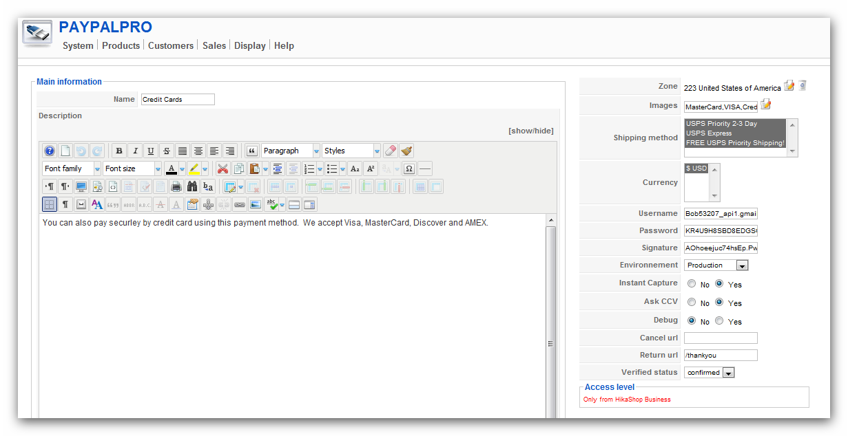

I've gone over the plug-in info and do not see anything that may or may not prevent the flow of this info to PayPal Pro (see attached in next message).
The reason I bought HikaShop Essentials was to be able to use PayPal Pro and keep shoppers on my site. If that means copying and pasting all of the shipping info into PayPal so that I can ship, I do NOT want this cart and hope to receive a full refund.

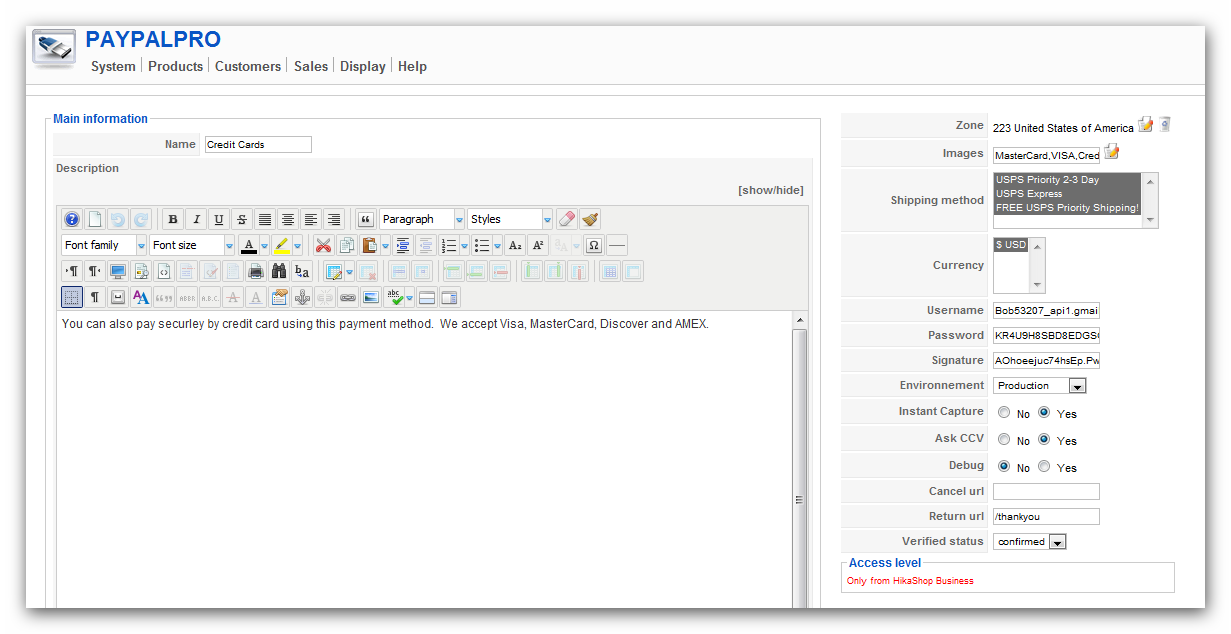

  • Posts: 22
14 years 10 months ago #28812
PayPal Pro
  • Posts: 22
14 years 10 months ago #28813
When using HikaShop PayPal Pro plugin, I do not get the order nor shipping address.

The PayPal Pro plugin is included with all the versions of HikaShop, even the free edition.
The problem is not in HikaShop. It's not possible to do what you want with PayPal Pro, using HikaShop or something else. Only with PayPal standard will you be able to send the address information to PayPal as well as the details of the transaction. You should use the PayPal standard plugin if you want to continue to work as you were doing previously. Unfortunately, there is nothing we can do to help you on that end as that restriction comes from PayPal.
