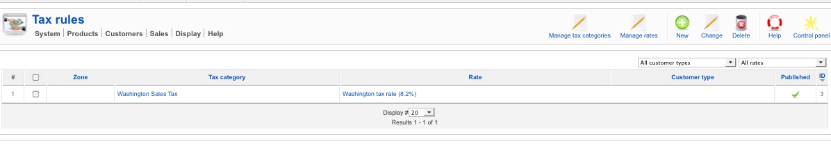

I am thoroughly confused. Following the above instructions, I tried to set up a rule where customers in my state (Washington) will be charged a sales tax. No taxes are charged to anyone outside of Washington. In my testing I discovered that taxes were either applied to everyone, or to no one at all. I just can't figure out how to make it work.

You're right, the problem with the email field and address form was browser related and has resolved itself. However, after creating two test orders - one within Washington and another in Oregon (no tax) - sales tax was applied in both instances.

Could you post a screenshot of your tax listing and the URL to your website so that we can test your configuration on your website ?
  • Posts: 31
15 years 9 months ago #3573
Here is the link. Screen shot of tax rule attached.

In your screenshot I see that you didn't set the limit on the washington state ( the zone column value is empty ). So, it's normal that the tax is applied whatever the address. You should edit your tax and select your zone.

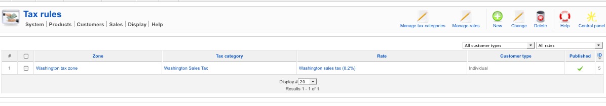

I'm still not getting it. After trying again with a Washington address, now no taxes are applied. Here is a recent screen shot of the tax rule.

In Zones you have to enter Washington as the default zone and type as State.
The way you have entered it I guess the system does not point this zone to the state "Washington"
Edit: Meaning when you add the zone again click in the little icon in the Zone, find Washington in states and add it.
