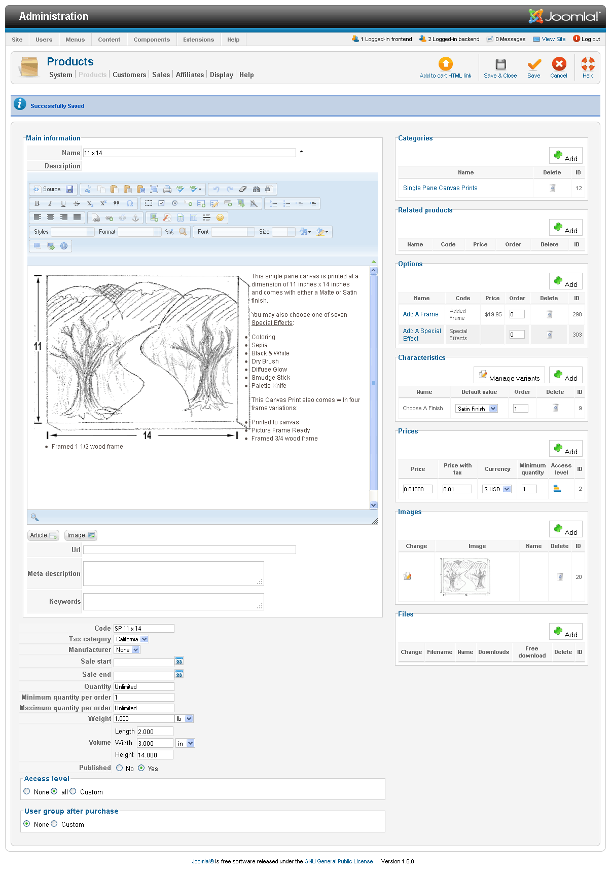

I am trying to get UPS to work and all I get is the following error message: Error while sending XML to UPS. Error code: 111030. Message: Packages must weigh more than zero pounds.
I have set the dimensions and the weight to 1.5 lbs

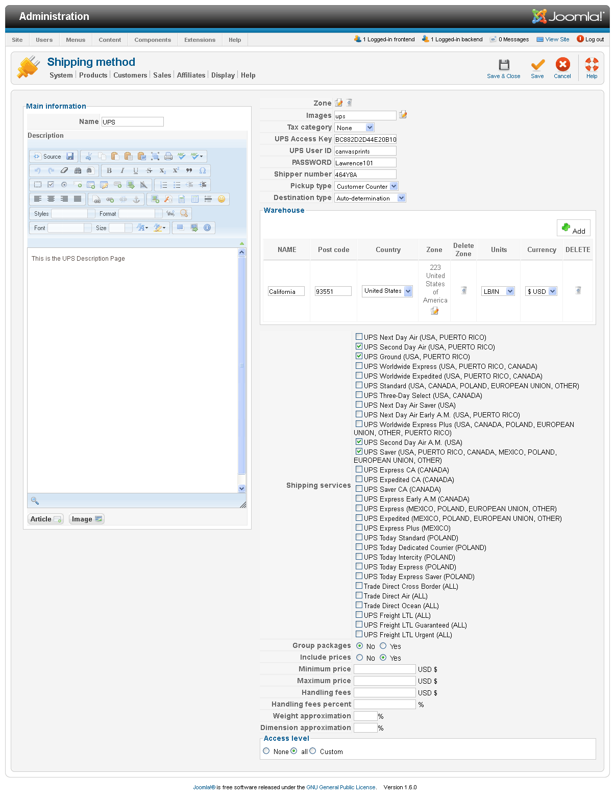

No one had such error so far. It must come from the way you setup the plugin or your products. Could you do screenshots of these so that we can see how you set them up ?
  • Posts: 45
14 years 10 months ago #27629

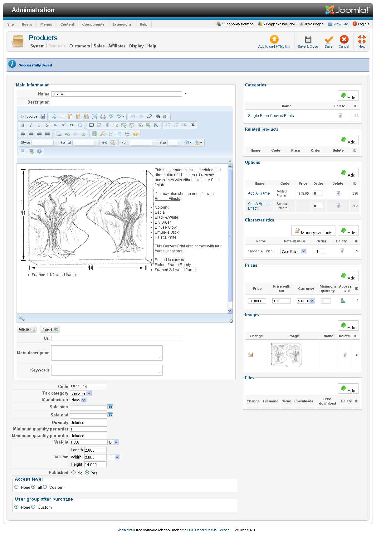

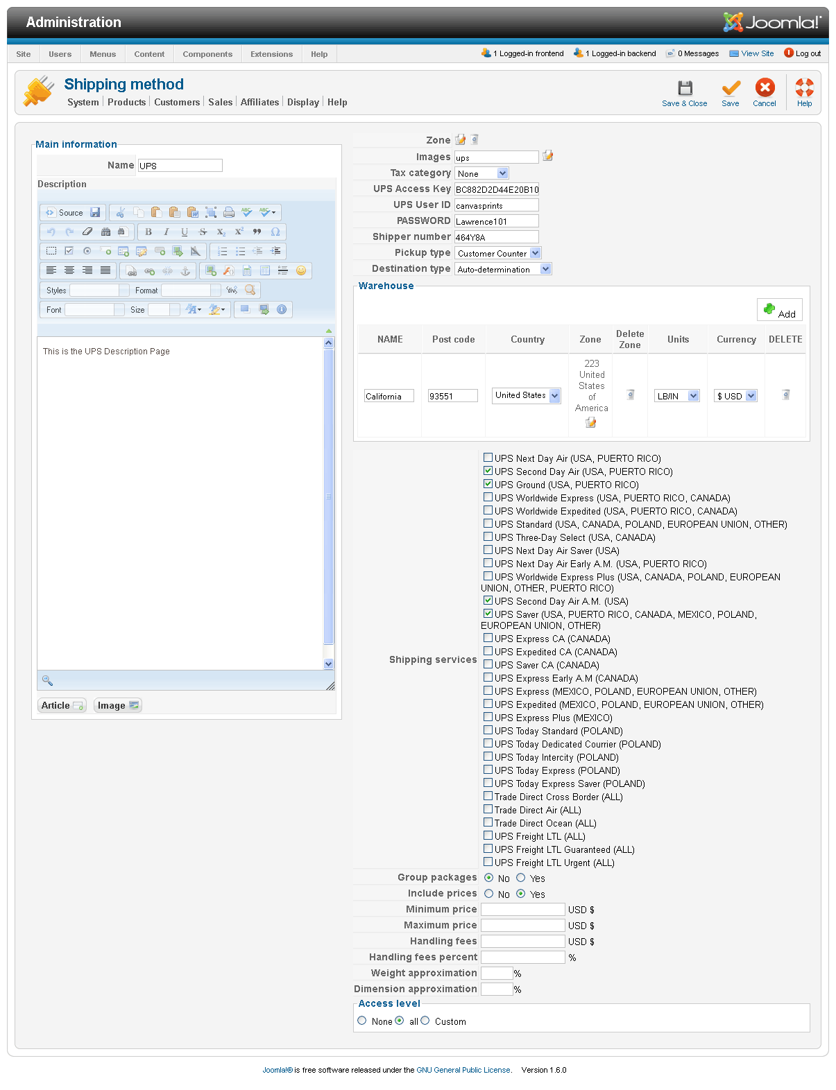

Here are some images.
  • Posts: 45
14 years 10 months ago #27630
Number 2

14 years 10 months ago #27631
Please make sure that the first weight unit in the "weight units" option of the configuration is lb.

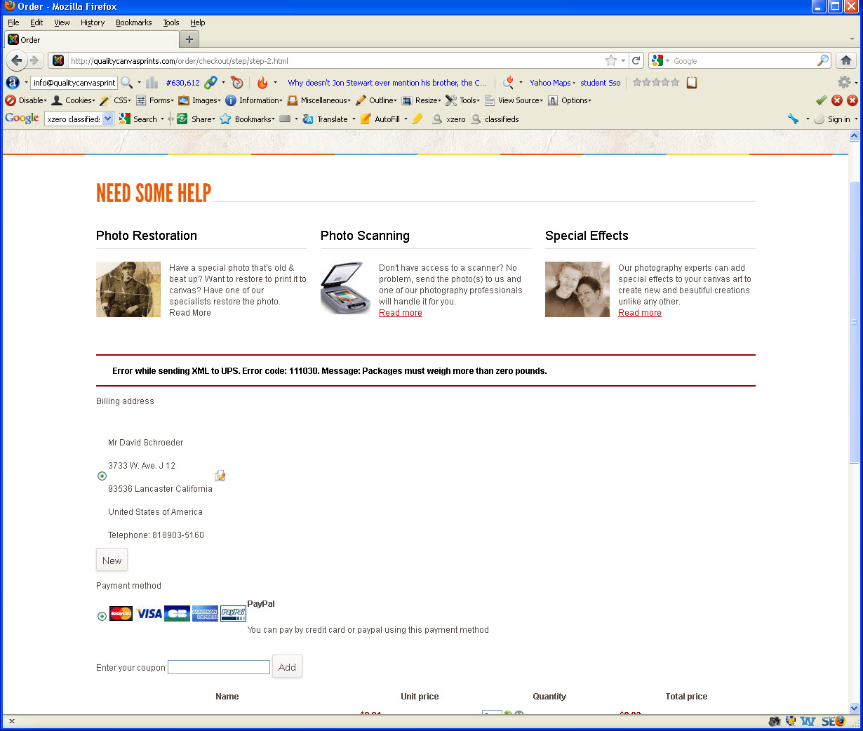

14 years 10 months ago #27632

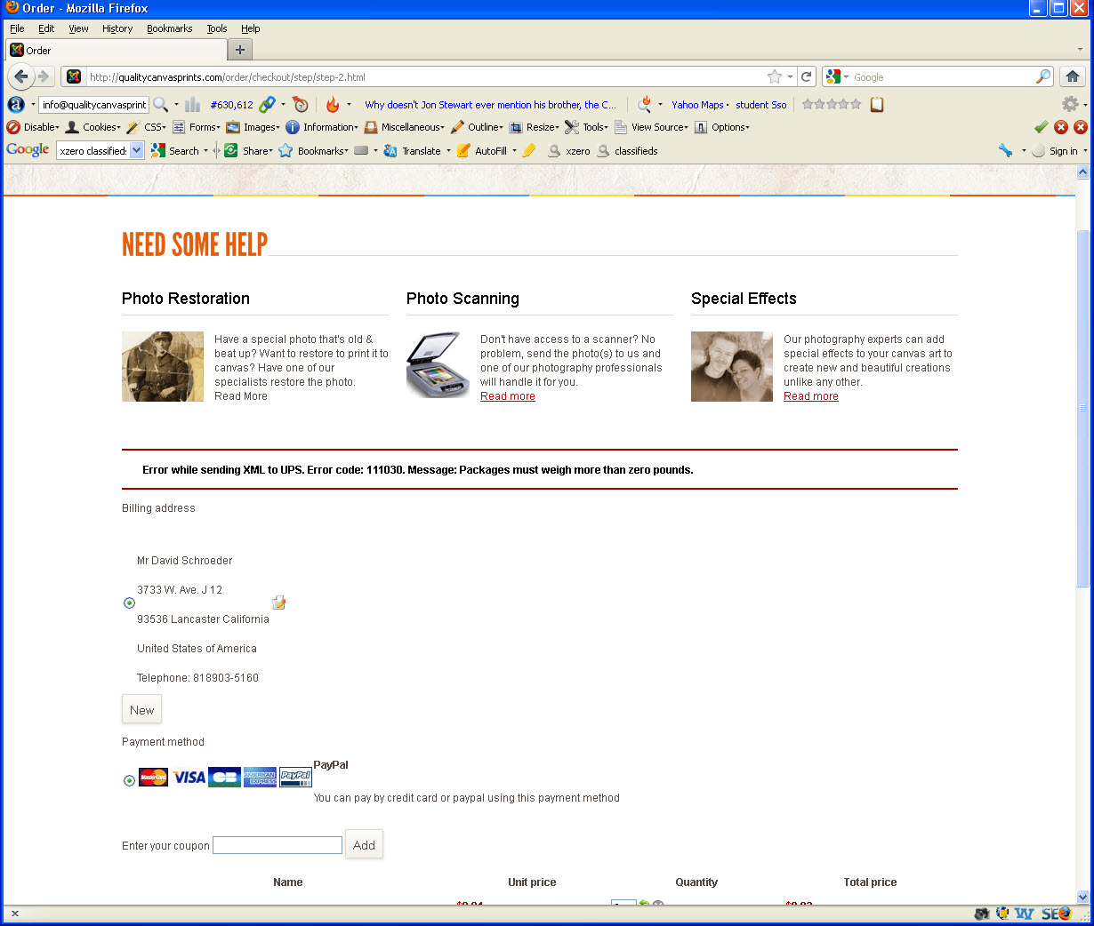

Error message.

Yes it is all in pounds (lb).

14 years 10 months ago #29536
The thing is that you need to use the same weight unit everywhere.
In UPS, you set it to use lb. So you should have the main weight unit as lb and the products weight as lb too. That way, no conversion will occur at all and you should not have a problem.
