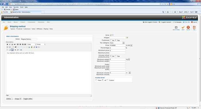

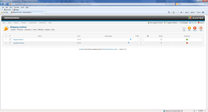

The problem probably comes from the way you setup your shipping methods ? Could you do screenshots of that so that we can see what you did ?
  • Posts: 49
14 years 10 months ago #27700
Thanks for you help, attached please find screen shots.

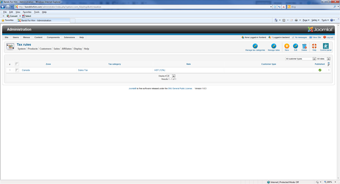

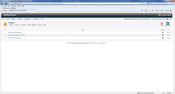

  • Posts: 49
14 years 10 months ago #27701
another
  • Posts: 49
14 years 10 months ago #27702
another
  • Posts: 49
14 years 10 months ago #27703
another
  • Posts: 49
14 years 10 months ago #27704
last one.
  • Posts: 86179
  • Thank you received: 14217
14 years 10 months ago #27711
I just tested on your website and I see the shipping method Regular Delivery $10.00 with the Canada selected in the address.
So that seems to be working.

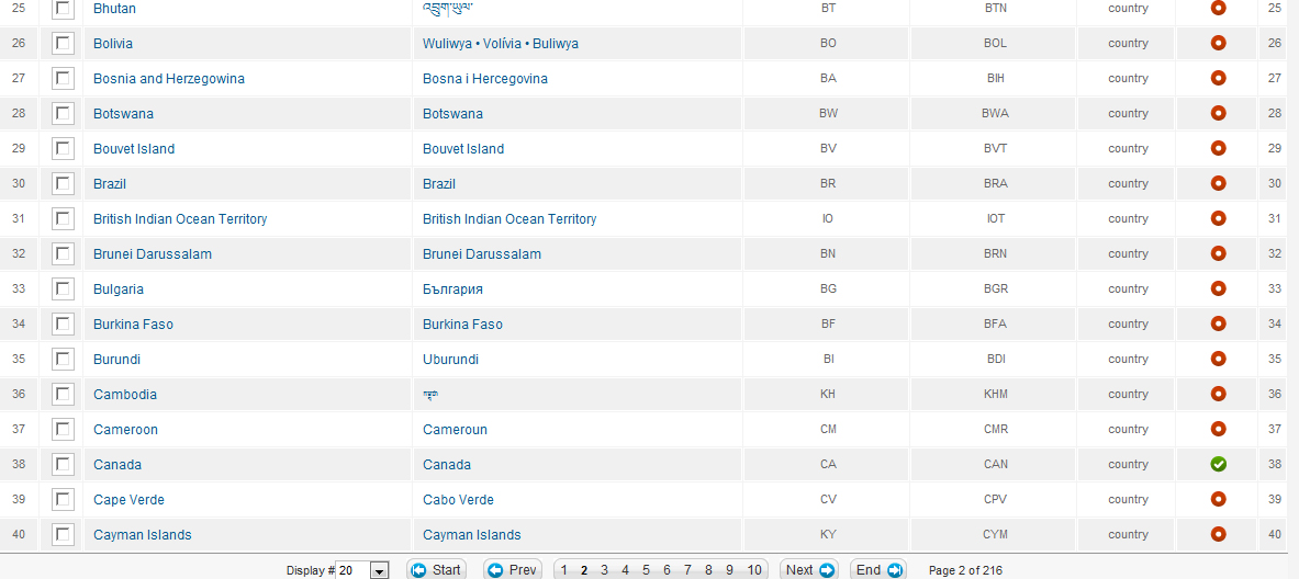

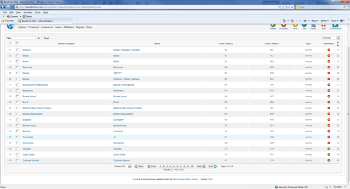

  • Posts: 49
14 years 10 months ago #28436
This image shows it is selected for Canada and turned on

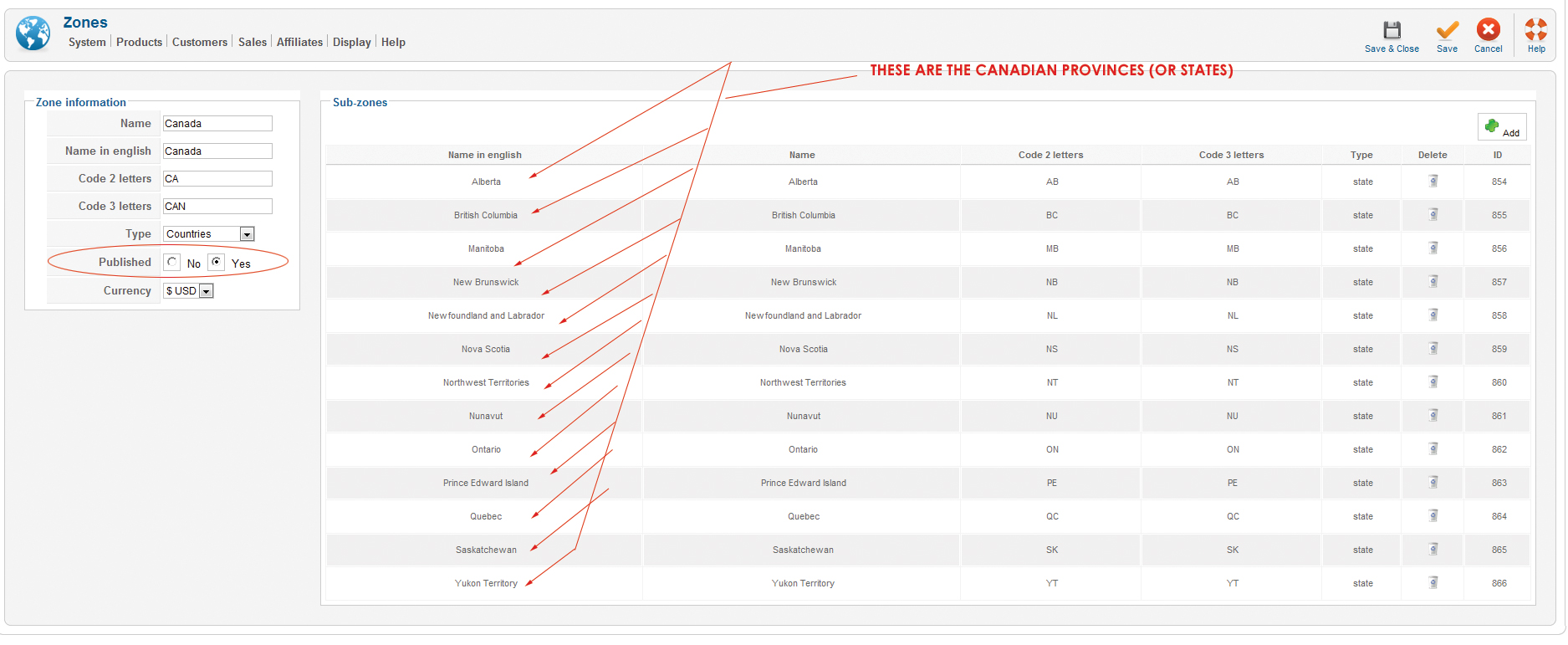

  • Posts: 49
14 years 10 months ago #28437
This image shows there are provinces showing under Canada and that they are turned on...any assistance would be really helpful. Thanks
  • Posts: 86179
14 years 10 months ago #28460
Your first screenshot shows that the canada country zone is published. But that we already know since it is displaying in the country dropdown.
However, it doesn't show the canadian states which should also be published on that listing. Please do a screenshots of the canadian states in the zones listing.

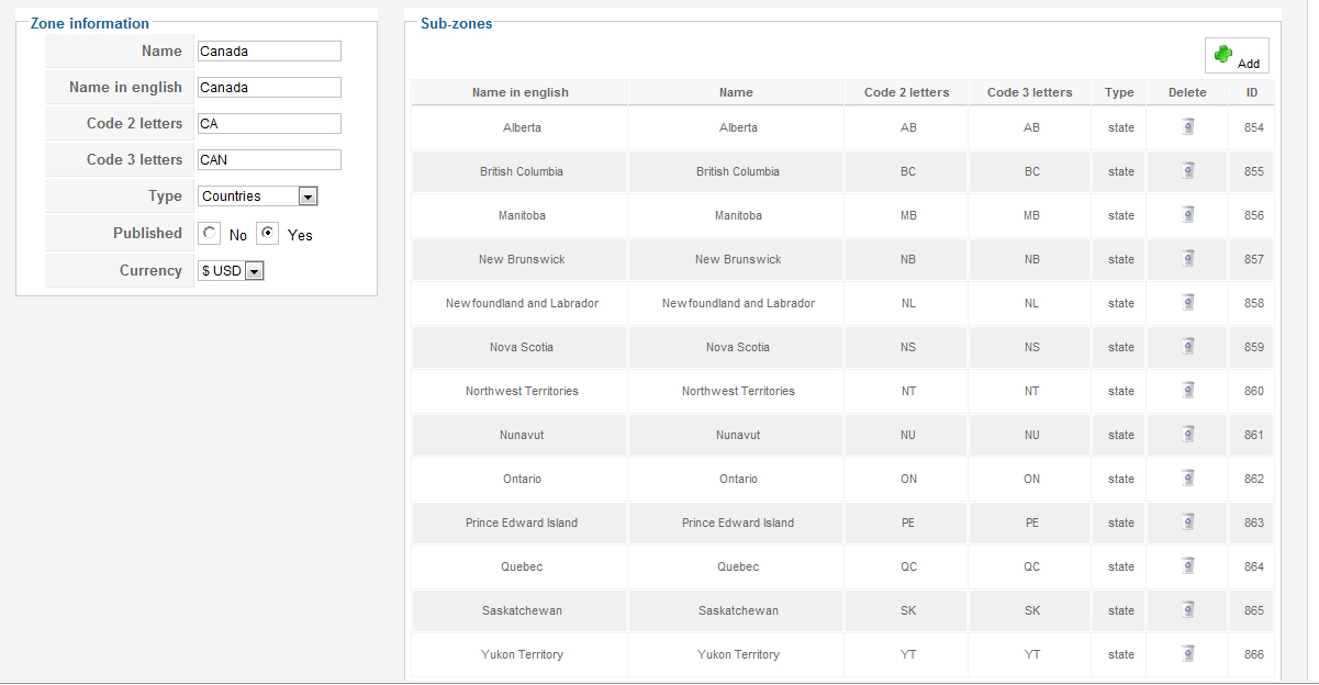

  • Posts: 49
14 years 10 months ago #28475
I've highlighted the Canadian provinces (states) in red and that they are published...
  • Posts: 86179
14 years 10 months ago #28495
That's the listing sub sub zones of the canada where you've added the states of the canada.
It doesn't show whether or not the states of the canada are published or not.
You need to check on that in the listing of the zones, not here.
  • Posts: 49
14 years 10 months ago #28509
Thank you so very much - sorry for my idiotness. You guy are simply the best.
