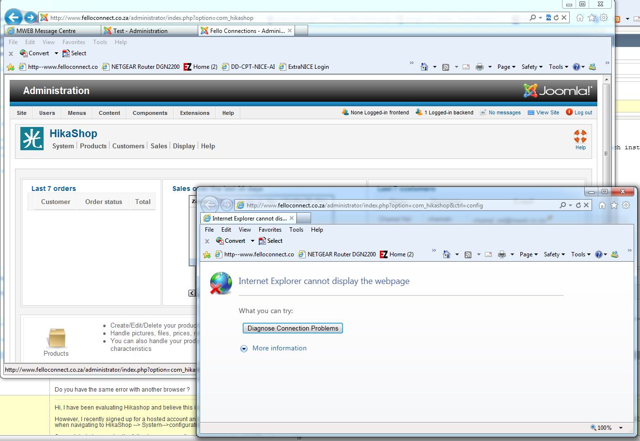

  • Posts: 8
14 years 10 months ago #28218
Thank you for your reply.
For the live/hosted site I tried using IE9 and Firefox - both same result - when I go through administrator I can navigate to e.g. products, categories, etc
I also uninstalled the extension and tried installing again - same problem. Then extracted all files and re-uploaded to web site and tried again. Still same problem. Each installation indicated no errors
Here is a screen shot (opted to send to new IE Window instead of new TAB so that I could fit both the screen before I launched the selection and the faulty page).
I appreciate your assistance.
  • Posts: 86114
  • Thank you received: 14210
14 years 10 months ago #28219
The error in the screenshot does not give much information. Please click on the "more information" link a do a screenshot of that ?
Also, could you do a screenshot of the error in firefox ? I suppose that it's not the same error message.

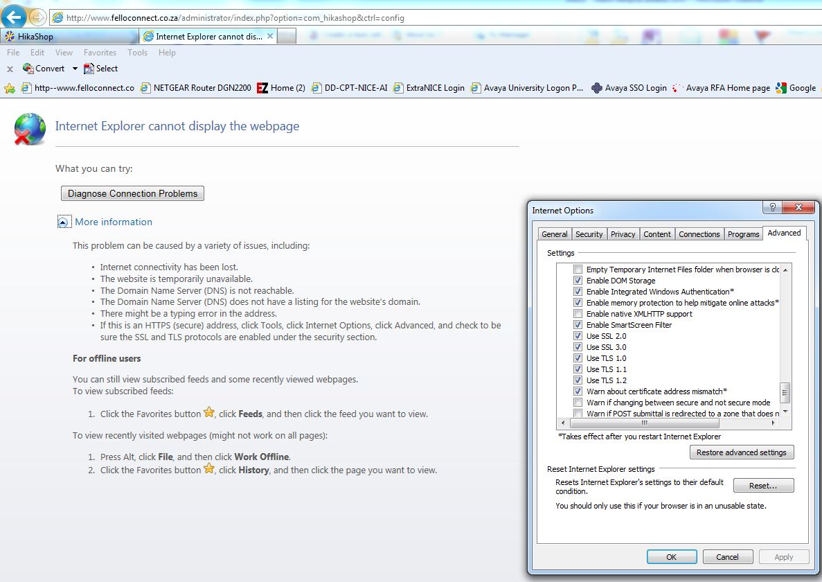

  • Posts: 8
14 years 10 months ago #28249
Here is the more info screen shot - I'll screenshot the FireFox one shortly, but it really give a totally blank page with no error message or more information option at all.

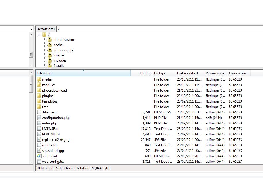

  • Posts: 8
14 years 10 months ago #28456
Thanks Nicolas
Yes. I have the correct filename as per below. Am I missing something else? I am assuming that the error outputs will be displayed in the browser?
