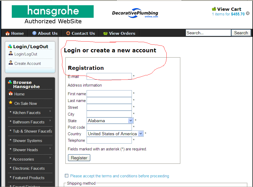

what view to edit.....
  • Posts: 223
14 years 10 months ago #28995
for the area circled in red on this page
  • Posts: 86179
  • Thank you received: 14217
14 years 10 months ago #29008
If you want just to change the text/remove it, you can override the translation as explained there:
www.hikashop.com/en/download/languages.html#modify
Otherwise, that can be changed in the file login of the view checkout and the file registration of the view user that you can edit via the menu Display->Views.
  • Posts: 223
14 years 10 months ago #29067
got it! did the trick...thanks
