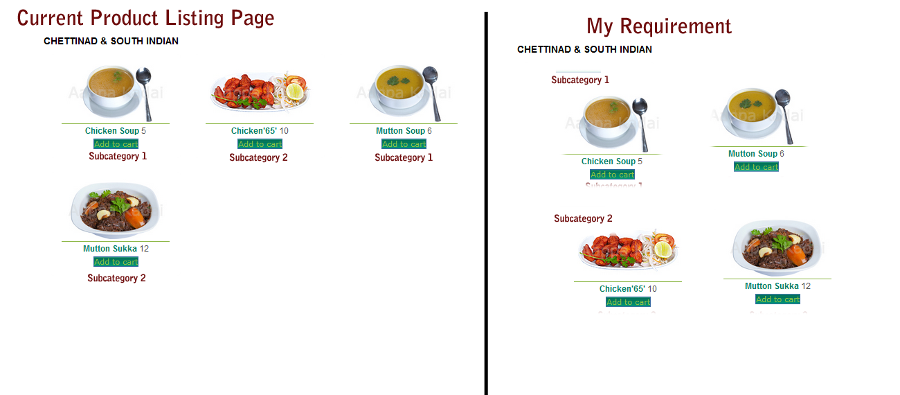

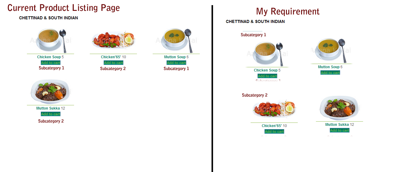

I would like to know if i can display products in under each subcategory in category listing page. My scenario is like show the category listing page with subcategories (this is happening with the default template structure of hikashop) and then i need to display the products in the same category listing page under each sub category. This is for avoiding more clicks and give a user friendly workflow to the client. So let me if this is possible ?.
There is one alternative to this method by using the product listing page but i need to segregate products based on subcategory. Now i am able to show all the products under the main category in product listing page but it is displaying in a random manner. If i want to do this my modifying the queries and code means in which files i need to make changes.
Kindly help me on this matter.

You can't do a display like that. Not unless you heavily modify the code.
For the products listing, you should look at the hikashop options of it and make sure that the random option is turned off, otherwise the listing will be random. Then, you can order the products based on the ordering you define in the listing of products on the back end when you display the products of a category.

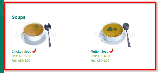

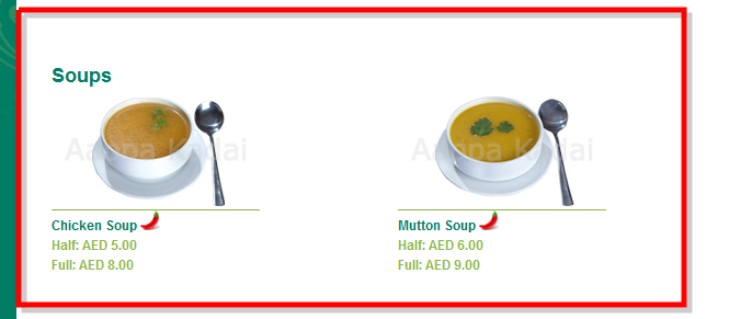

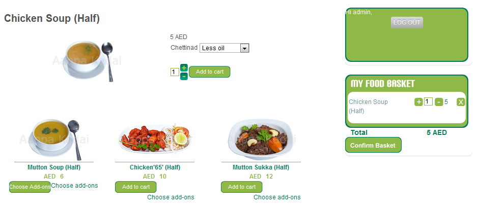

Thanks for the great support. The product listing in category page is working perfectly now. Now i have a query and this is regarding the options of a single product. Assume that i have product called T-shirt and it has three sizes like Small , medium and Large. The price for the T-shirt will be changing as per the size of the T-shirt. For eg T-Shirt Small 5 Dollars, T-Shirt Medium 6 Dollars, and T-Shirt Large is 7 dollars. Users should be able to select the size and then add the product into the cart.
Kindly advice me if i can do this using hikashop. It would be great help if you could guide me to achieve this option.
Attached our product demo with each items having two quantities like half and full.
Binoy
The topic has been locked.
  • Posts: 86179
  • Thank you received: 14216
14 years 9 months ago #30676
You can use characteristics for that:
www.hikashop.com/en/support/documentatio...html#characteristics
That will create variants for your products and you will be able to set a price for each variant and have a specific add to cart HTML button for each variant.

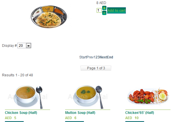

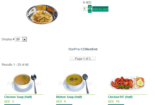

Thanks for the support. I have one more concern now like, i have created product pages with related projects in the bottom of the product page but when listing the related products it is showing only 20 items in the first page .And if we click on next button or page number 2 it is showing error. So instead of that i want to display the whole list in a single page without pagination. The maximum number of related items i have is only 50 so i need to display the whole set of 50 items in a single page. I have tried removing the pagination code from lising.php file and also i gave the number of items in product display settings as 60. But still the same thing is happening.
Kindly help me to solve this issue. We are almost ready launch the site and your tool was satisfying most of our requirements except few. Thanks for such a good opensource product.
Screen shot Attached.
BInoy
  • Posts: 86179
14 years 9 months ago #30946
If you want to remove the pagination in that related module, you should just increase the "number of items" option to 50 in your related module's hikashop options that you can access via the menu Display->Content modules.

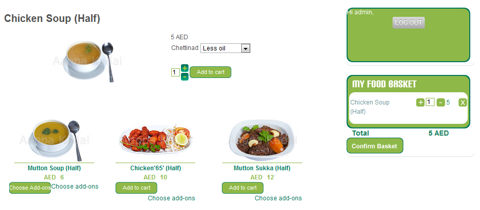

Sorry for coming with new new issues everytime. Now i am facing problem like, characteristic is not displaying in cart even if i select a characteristic for a product. Please find attched the screen shot, inwhich i have selected less-oil as charecteristic for the product Chicken Soup (Half)but it is not displaying in the cart.
So kindly help me on this.
Binoy
  • Posts: 86179
14 years 9 months ago #31246
You should turn on the option "Append characteristics value to product name" in the Display tab of the configuration for that.
