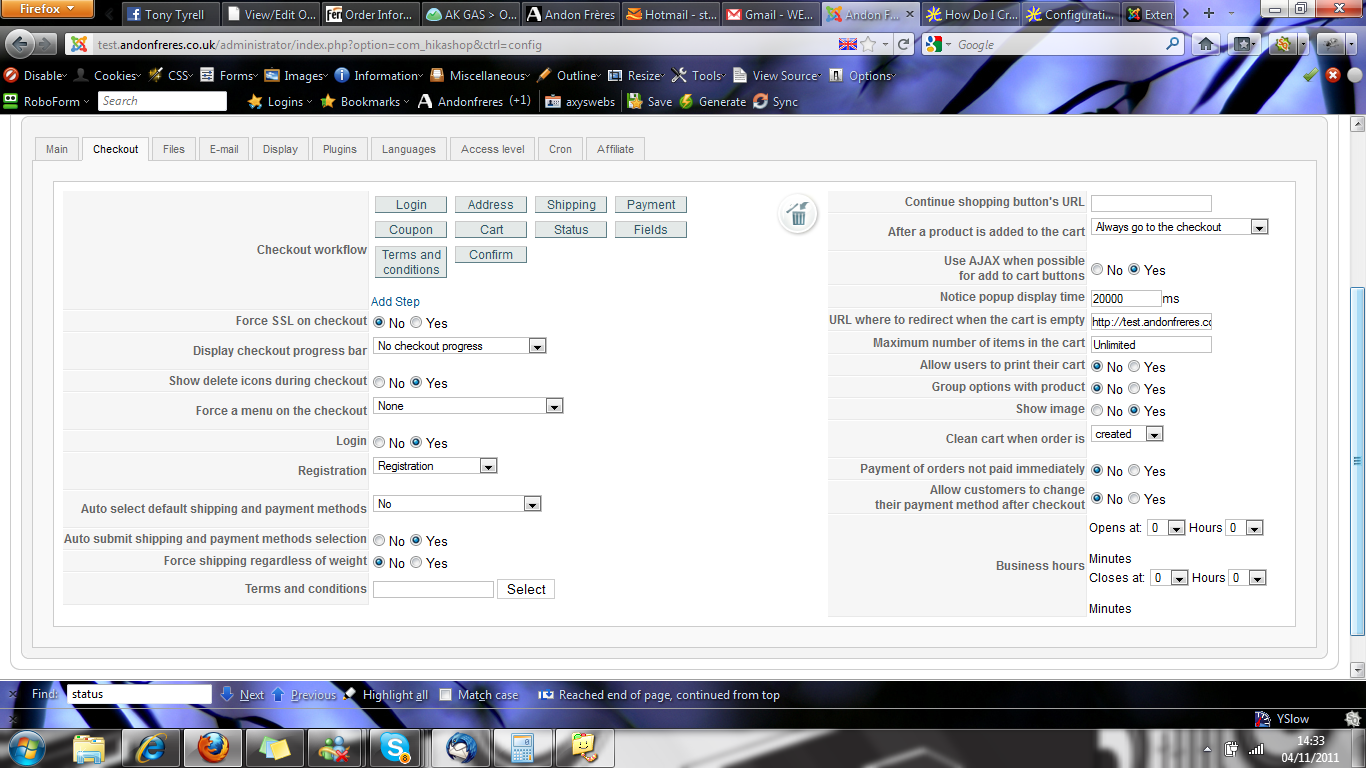

maybe im missing something but I cannot see an option to deactivate the advance mode. I have uploaded a screenshot

  • Posts: 86179
  • Thank you received: 14217
14 years 10 months ago #29091
If you download again the installation package from our website and install it over yours that will display that option. It should actually also fix the problem you're having with using the checkout workflow edition interface.
Well, the thing is that you need to choose.
If you have a workflow like that:
Step 1. Cart Fields
Step 2. Login Confirm
The address selection won't display but it won't go to the thank you page. You will just have an empty page with a next button on step 2 when the user is already logged in.
In that case, why not have only one step like that :
Step 1. Cart Fields Login Confirm
Then it won't display an empty step.
