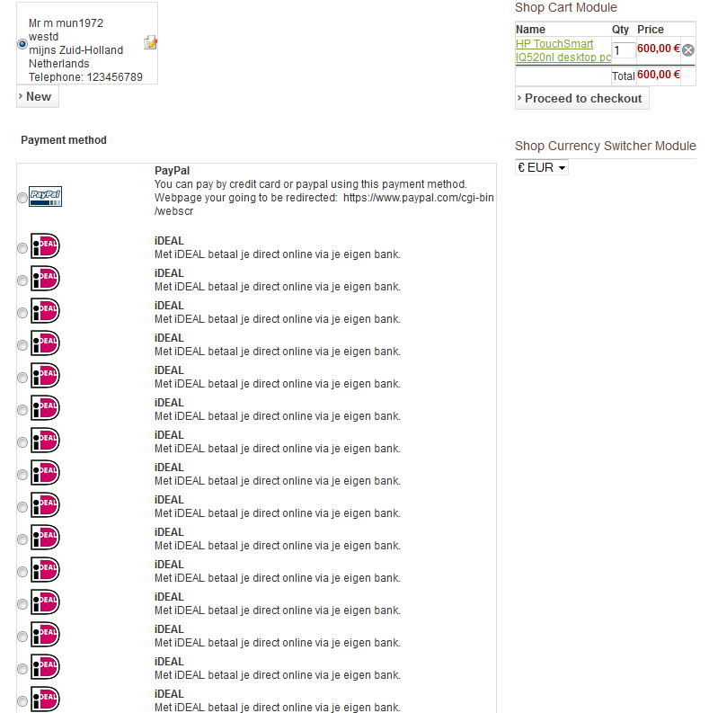

But now i see 35x the same iDEAL payment methode in checkout?! See attachment
It's comes out of the db because i see the same amount of payment id's in the jos_hikashop_payment table.
Screendump front-end website.

14 years 10 months ago #29389
That's because you payment plugin install process was launched several times.
You need to delete all the entries in the table hikashop_payment via your phpmyadmin and then install it once.
  • Posts: 3
14 years 10 months ago #29394
Can i only delete the iDEAL entries?
I 've got payment id 1 Paypal , payment id 2 - 24 iDEAL , payment id 25 collect deliver, 26 bank transfer, 27 credit card and then 28 until 35 iDEAL. Or can i delete everything?
  • Posts: 86179
  • Thank you received: 14217
14 years 10 months ago #29406
Yes, just delete the iDeal entries.
