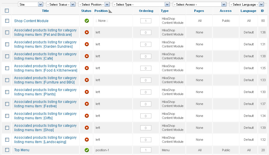

Please see attached screenshot image: I have renamed each of the Hikashop content modules in accordance with their associated categories, rather than the associated menu item number, then used the same set of modules for both the top and side menus, to make finding the right module simpler and to save having 2 modules for each category. Is this ok?
Also, as you can see from the attached screenshot, the modules are disabled. It doesn't seem to make any difference whether they are enabled or not. Is this correct?

1. Yes that's ok. It's indeed better to find the one you're looking for easily :)
2. Yes it's doesn't make any difference. In fact you should leave them unpublished so that your template does not display them in the left column of your template.
