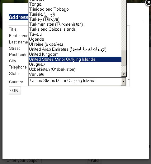

As this is my first post I wanted to say great job on HikaShop
Now, on to my issue...
1. There is no option for USA (United States of America, only USA outlying islands is displayed) on the country drop down for customer registration (Address Information during checkout process)
2. How do I change the default country? I don't live in France.. and most of my customers don't either.
3. How do I customize the form (where is the file?), and the format is wrong for US addresses, as State goes before postal code (and Postal Code is Mandatory)
Thanks in advance

However, United States of America is missing from the list of counties available.... is this from a file somewhere?

It seems that the data for Country is pulled from the database, (which does contain an entry for United States of America..) but if that is so why is it not showing up?

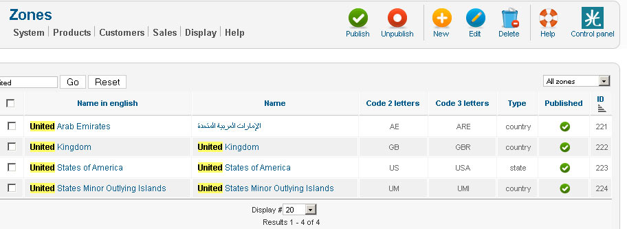

However, I did not delete it, or unpublish it. In fact I haven't done much at all, it is a new install... testing it out.
I have added 2 products, some categories and a tax zone
Anyways, am including pic of System > Zones that clearly shows the published state
Last edit: 14 years 10 months ago by sdebaun. Reason: I might be.... blind...?
  • Posts: 38
14 years 10 months ago #29794
OH! I see it... Type = State!
Now, how did that happen?? :unsure:
Thanks I've got it
  • Posts: 86179
  • Thank you received: 14217
14 years 10 months ago #29796
Yes, that's the problem. The USA is a state instead of being a country. So it's not displaying in the country dropdown. Just changing it to country will make it display.
