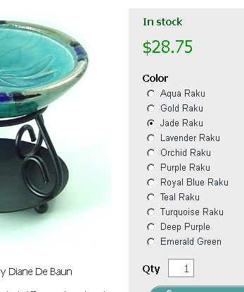

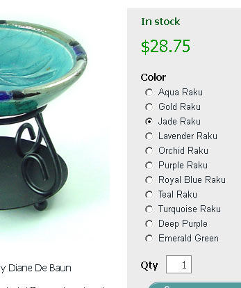

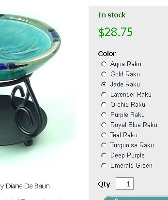

Now, the simplest option for characteristics would be a drop down menu, but I wanted to implement something like the following
It's nice to give all the options at once. That would be pretty simple with a list. I'm also hoping to implement some way of having a per item default color, to match the main product image.
Any ideas for that one?

In the Display tab of the config, you can select the "Characteristics selection method" for that.
The default value can be selected on the product page after you add your characteristic.
