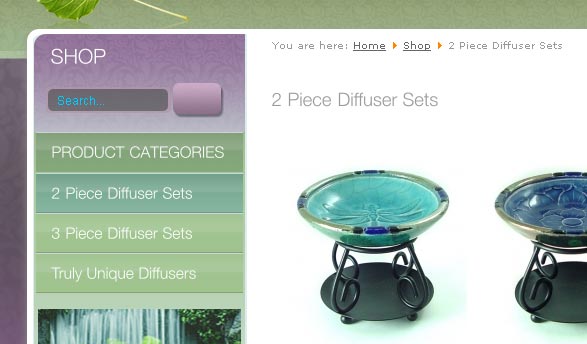

Any suggestions for creating a select state for category menu items?
I have a nicely functioning menu showing my product categories and I would like to "highlight" the item that corresponds to the category being viewed.
I don't see any "hooks" being generated by the code, I was wondering if you had any suggestions on how to implement this.
This image shows a selected category, but no select state to identify the category chosen

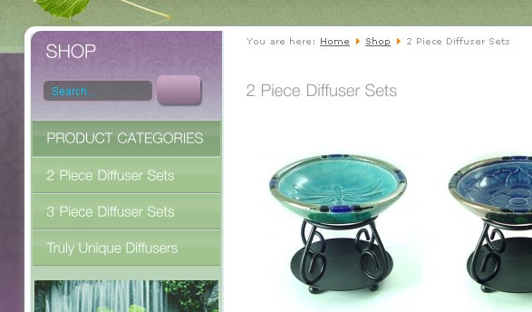

This is my rollover, and hopefully select state as well
Thanks again

14 years 10 months ago #29946
First image should have been
I'm sure you get the idea

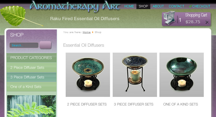

Image showing category menu in select state when viewing Shop page (No category selected - category menu is remembering the earlier selection before navigating to another main menu item page)

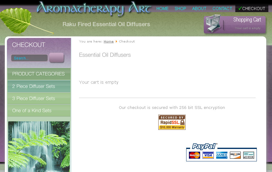

Well, that does solve the issue on non HikaShop pages like Home, About and Contact, but on the Checkout, and Shop page (no category selected - yet) the previous selected category is again "remembered" when visiting those pages because they are registering as hikashop components. Is there a way to be more selective, say not just any hikashop component, but a category or product view within the hikashop component?
