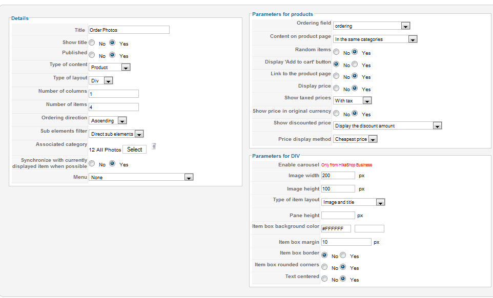

Here's my options for the Order Photos module.
  • Posts: 86179
  • Thank you received: 14217
14 years 10 months ago #30057
Do you have products directly in that "All photos" category ?
If not, it's normal that it is not displaying any product.
You should change the "sub element filter" to "all sub elements" filter to have the products of its sub categories displayed.
