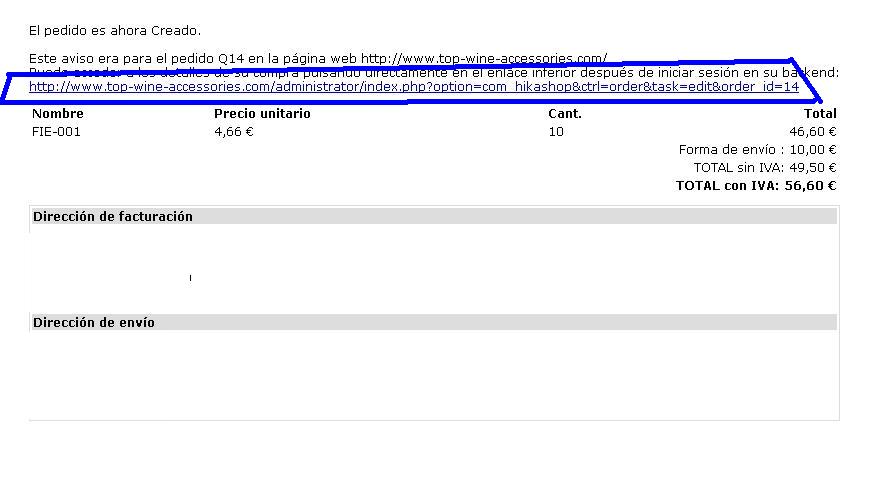

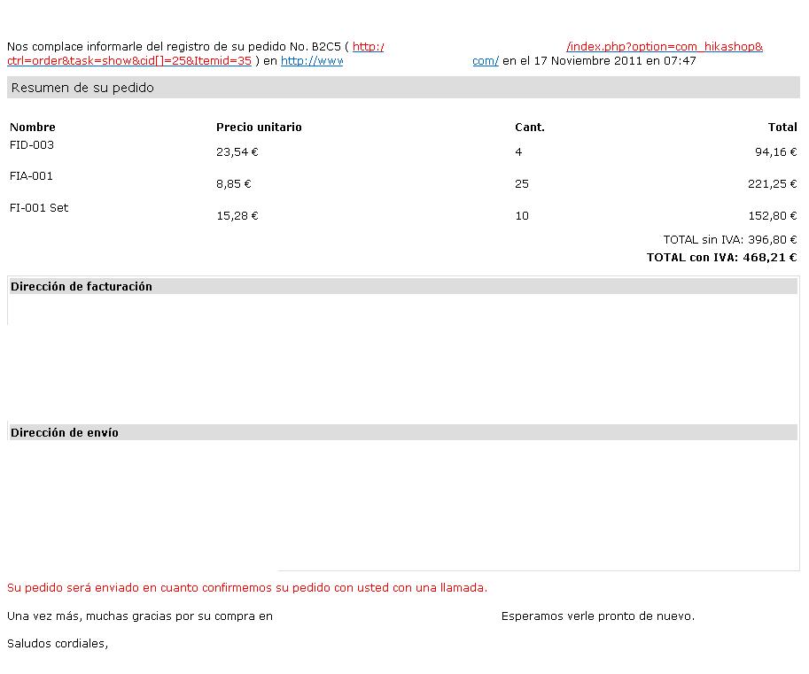

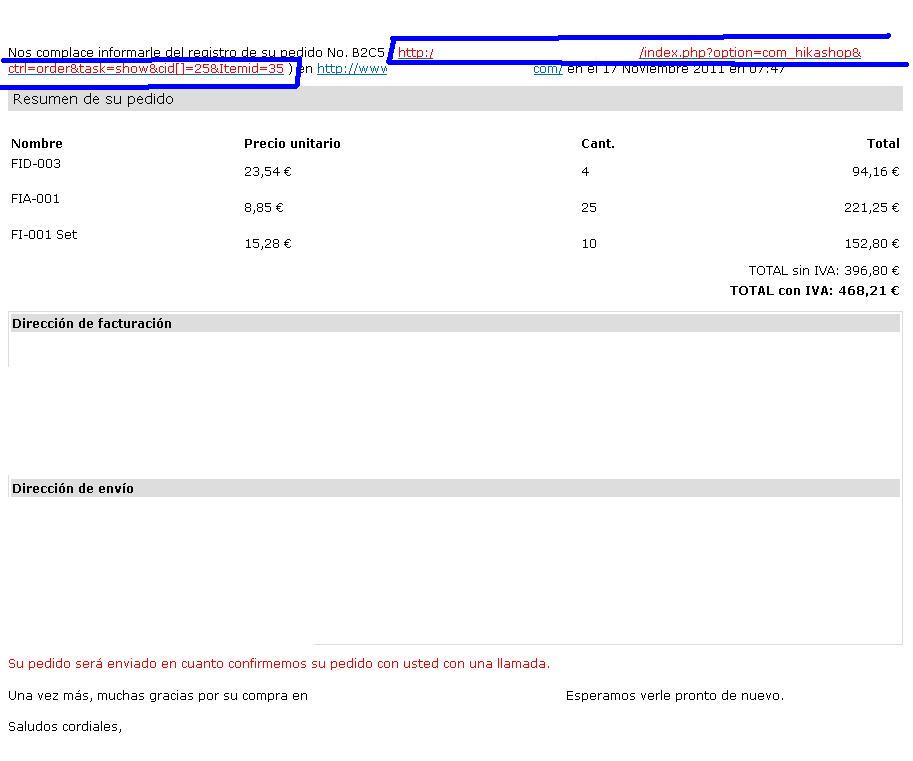

Hello, when somebody puts and order, i would like to erase some text (see picture) the part that is red, where can i do that ?
Thank

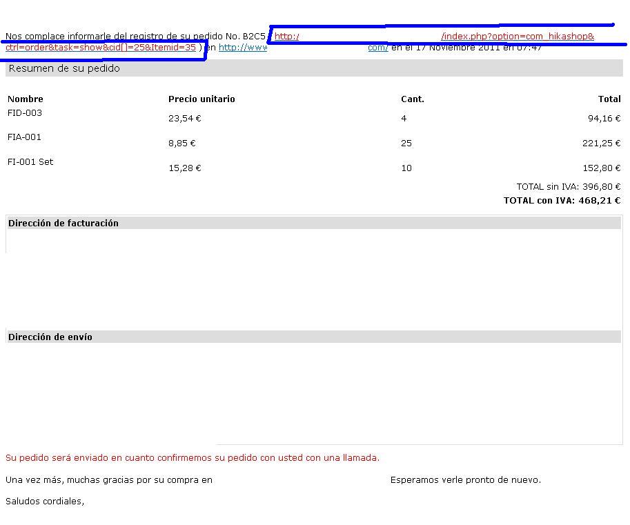

In my uploaded pictures, there is a red link (upper side).
How can i eleminate it ?
Thank you.

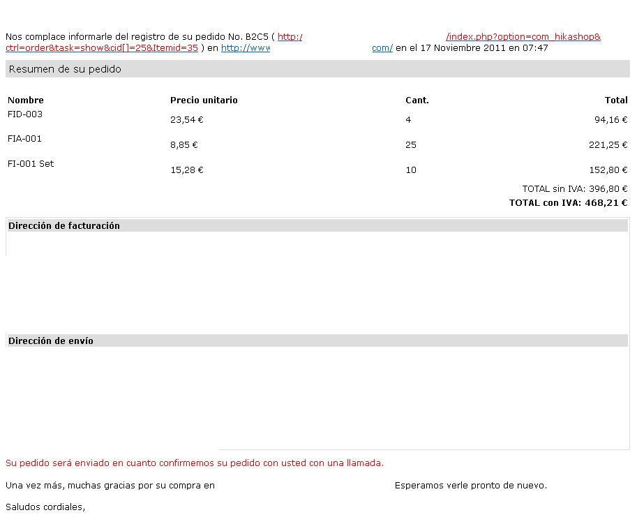

I add to pictures, its from the mail I recieve, and the other that the client recieve.

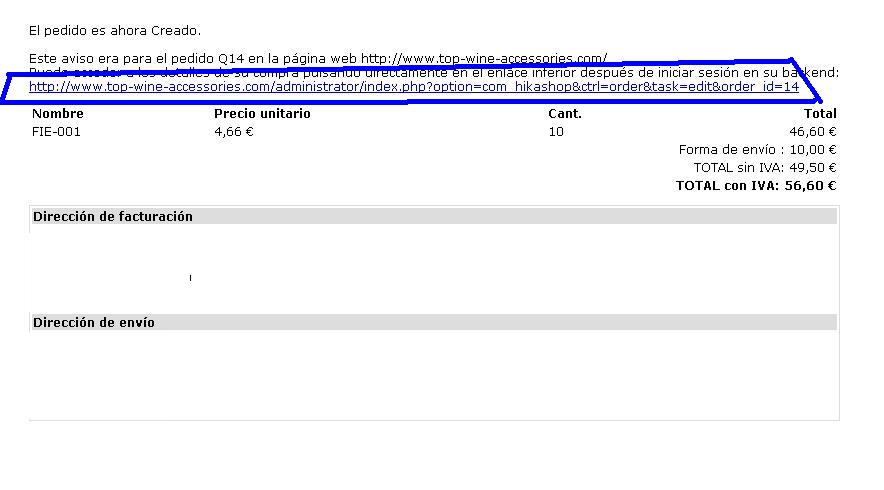

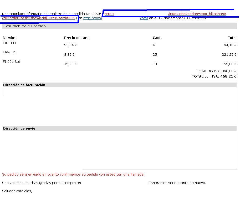

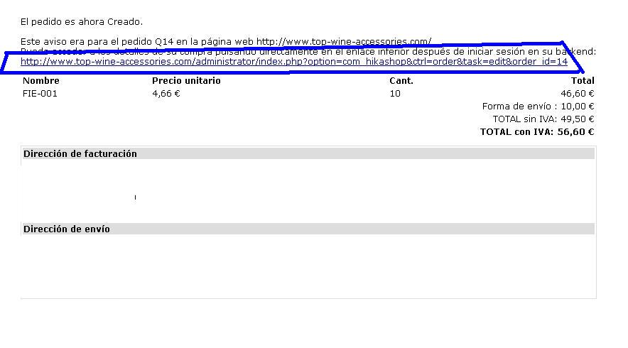

14 years 10 months ago #30372
Forget to upload this picture

If you want to remove the links there, you need to override the translation and remove the %s of the links there, as explained in my first message.
In the english translation file, it's this line:
ORDER_CREATION_SUCCESS_ON_WEBSITE_AT_DATE="We are pleased to confirm the creation of your order No. %s at %s on the %s at %s"
If you use:
ORDER_CREATION_SUCCESS_ON_WEBSITE_AT_DATE="We are pleased to confirm the creation of your order"
that will remove the links.
