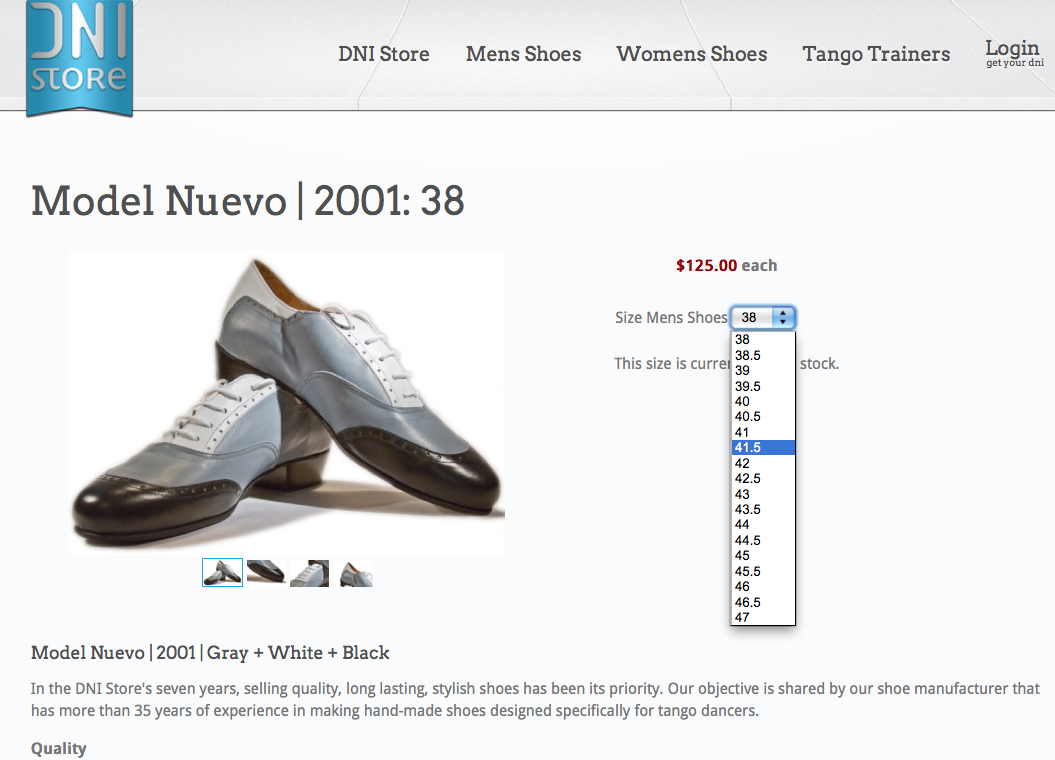

Interesting because the older site that was developed also with hikashop seems to have this posiblity.
dni-tango.com/us/mens-products/product/s.../category_pathway-13
