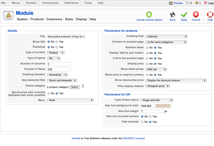

I want to enlarge the image on the product page without loosing the tumbnailsize in the product-overvieuw/listing.
I understand i could enlarge the size of all thumnails trough System-> Configurations -> Files.
And then give a maximum size in the display -> contentmenu/module so on that places the images would be small again..
Am i getting this?
Now my question.. i have no place in the content module or menu to do this? :S
(see screenshot)
Can you help me out? (And maybe make one short 'How To' for everyone who is struggling with this over and over again :blush: )
  • Posts: 86179
  • Thank you received: 14214
14 years 7 months ago #39833
Please use the latest version of HikaShop. With it, in the Files tab of the configuration, you can setup the size for thumbnails and for the image on the product page.
