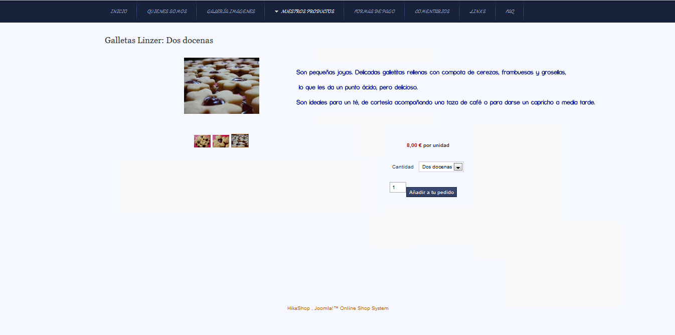

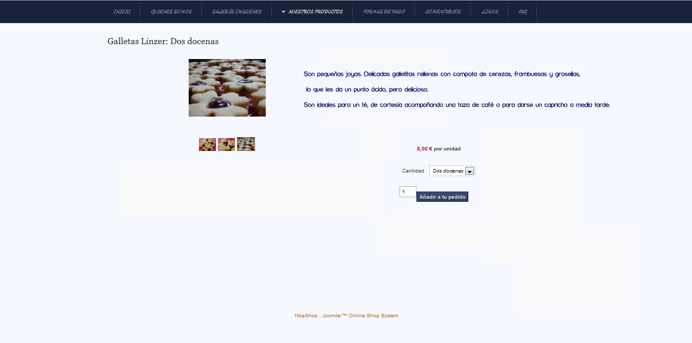

Hello, I would like to change the description of the product
Now I have to do; www.claradehuevo.com/webprueba/index.php...o/12-galletas-linzer
But I want to do
This is an edited picture by photoshop
What do I have to change?
Thanks!!

14 years 9 months ago #30902
You should move the code:
<div id="hikashop_product_description_main" class="hikashop_product_description_main">
<?php echo JHTML::_('content.prepare',preg_replace('#<hr *id="system-readmore" */>#i','',$this->element->product_description)); ?>
</div>
inside the div hikashop_product_right_part in the file 'show' of the view 'product' via the menu Display->Views.
If the width of the description is too big, the whole right part might go below the image. In that case, you will need to add some CSS like that :
.hikashop_product_right_part { width: 400px; }
in the front end CSS that you can edit via the Display tab of the configuration.

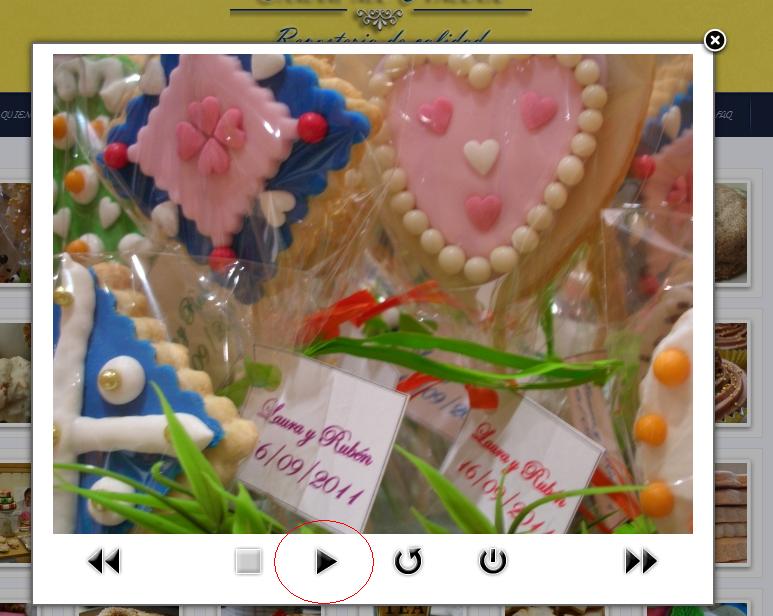

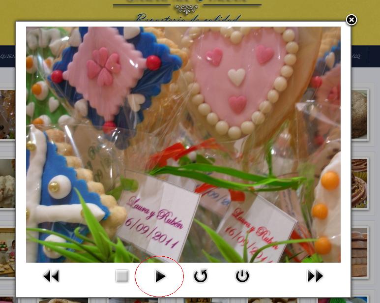

I have another question.
By increasing the images of my products
How I can add a button next or play like these?

14 years 9 months ago #30957
There is no option for that.
You would need to override the image display by using another shadow box system. But that require programming skills.
We have some documentation for developers about that here:
www.hikashop.com/en/support/documentatio...tation.html#override
