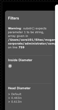

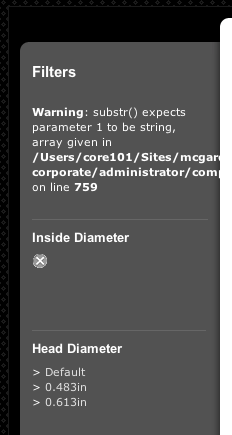

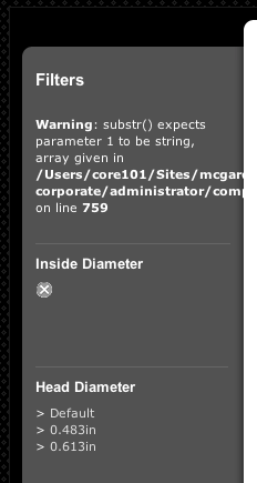

14 years 9 months ago #32006
The new filter.php file did help, thanks. I'm still having errors, however. When I click an option to filter, it comes back with the delete button but it doesn't tell me what I selected. I also get an error: Warning: substr() expects parameter 1 to be string, array given in /Users/core101/Sites/mcgard-corporate/administrator/components/com_hikashop/classes/filter.php on line 759 The lines are:
$html=substr($html,0,-2);
$val=substr($val,0,-1);
Screenshot is attached. Could you help with this? Thanks!
Last edit: 14 years 9 months ago by mmccarthy. Reason: added error lines
  • Posts: 86179
  • Thank you received: 14216
14 years 9 months ago #32032
Could you try to update to version 1.5.5 of HikaShop ? You can download it here when logged on our website:
www.hikashop.com/en/account/your-subscriptions.html
