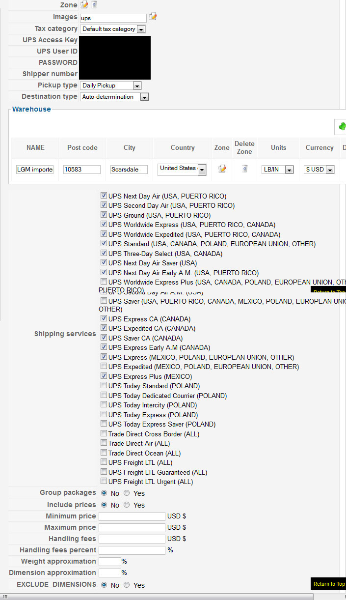

14 years 1 month ago #58768
Here you go... It is of course active.
Cheers

  • Posts: 86114
  • Thank you received: 14210
14 years 1 month ago #58839
Can you check that you have the United States of America selected in the "country" column of the warehouse and not the "United States Minor Islands" zone ?
Other than that everything seems fine in your shipping method.
Can you check that you have a weight and dimensions in your products too ?
Also, do you get an error message during the checkout when manual shipping methods are off and ups is on ?
Normally, if you don't see any shipping methods selection, you should get such error message telling from where the problem is coming.

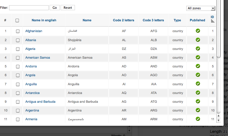

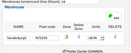

  • Posts: 26
13 years 9 months ago #78880
I am having this problem with Canada Post shipping. No warehouse available for your location.
I have all of my available countries selected.
Here are some screenshots. Only people from Canada can successfully complete their order...
13 years 9 months ago #78944
I think that you have to remove the zone in the warehouse parameters.
  • Posts: 26
13 years 9 months ago #78984
So un-publish all of these zones that I have listed above?
O do I completely delete the warehouse?
Last edit: 13 years 9 months ago by Vanderburgh.
13 years 9 months ago #78992
You'll just have to remove your warehouse zone and test it again.

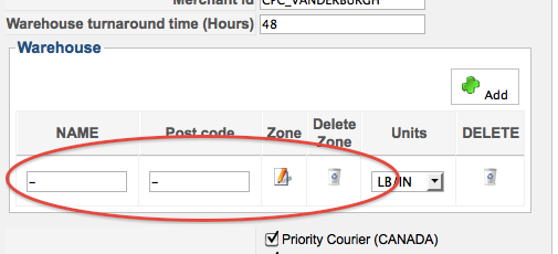

  • Posts: 26
13 years 9 months ago #79000
So take out my warehouse like this:?
Please confirm...

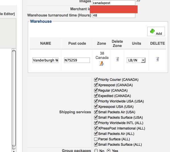

13 years 9 months ago #79014
No just the "38 canada" of the column ZONE which is telling you that this warehouse will only send goods for people from canada.
Last edit: 13 years 9 months ago by Mohamed Thelji.
  • Posts: 26
13 years 9 months ago #79022
So this then?
13 years 9 months ago #79027
Yes
