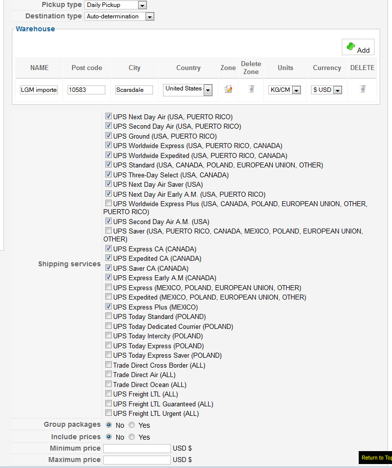

I am trying to set this up for a client as well.
I plugged in all their account info, added a warehouse location and still get the "No available warehouse found for your location" message
In my checkout, I found a valid USA address in Los Angeles to test with, but still says "No available warehouse found for your location" what else can it be?
I have set no zones on the warehouse or on the UPS shipping module itself.
I have set a number of possible UPS shipping options.
No idea what else to try, it is my first time trying UPS integration.
  • Posts: 86114
  • Thank you received: 14210
14 years 3 months ago #51332
Please do a screenshot of the options of your UPS plugin (and remove the UPS account info) so that we can see what you did.
  • Posts: 121
  • Hikashop Essential
14 years 3 months ago #51368
Here you go...
  • Posts: 86114
14 years 3 months ago #51452
These options are fine.
Could you try to use that plugin ? Maybe that will help.
