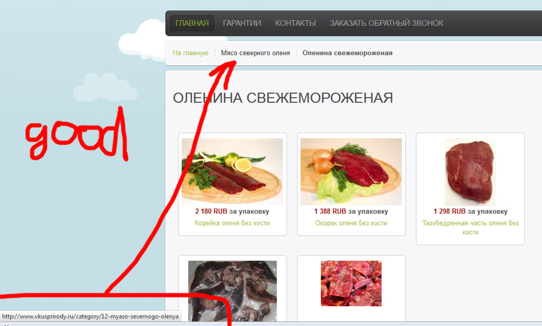

after change this line here is the result
sometimes wrong sometimes good
Я здесь добровольно!
Last edit: 14 years 9 months ago by progreccor.

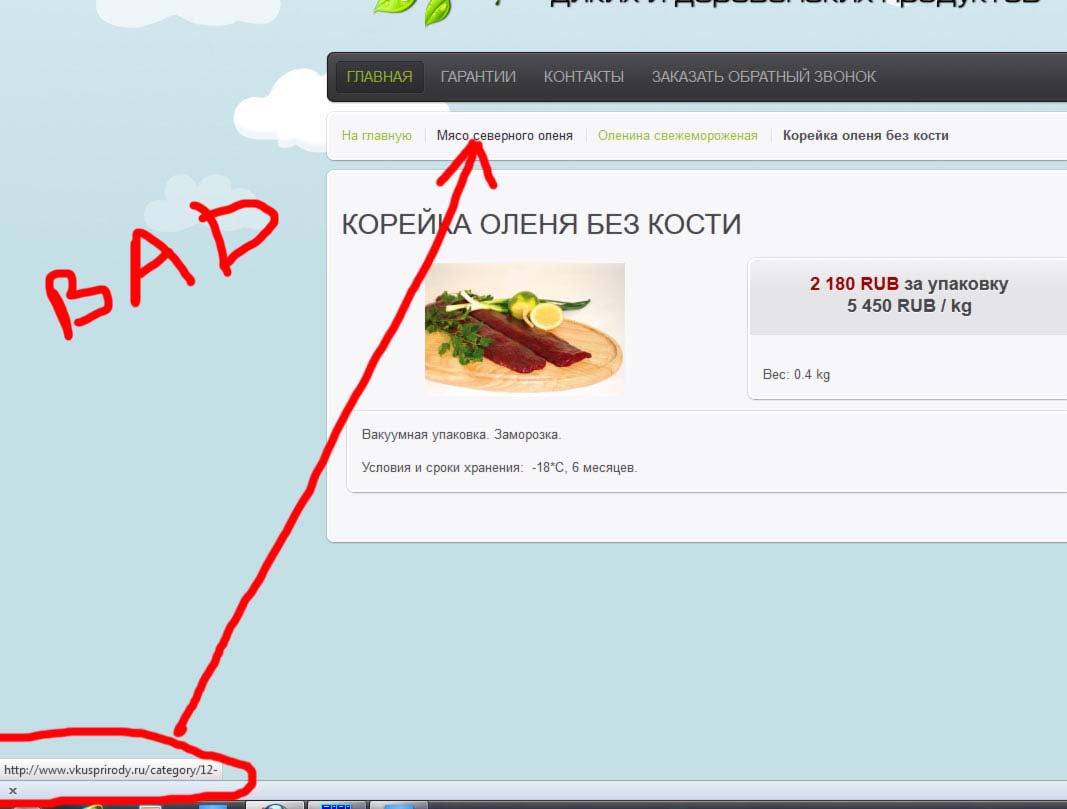

no. there is only one place
But the problem is that i go into the product page - the breadcrumbs is changed to wrong way.
I think that changes need to be in components/com_hikashop/views/product/view.html.php
i see that $pathway is there too. But the how to change i am not sure...
