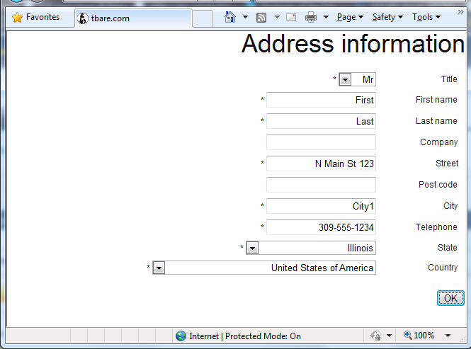

change address is right aligned
  • Posts: 10
14 years 9 months ago #31823
When checking out, after I register / log in, when i click on the "Change" icon next to the address, the new window looks like the image below, and all text is right aligned. This is very confusing. I see a "<link rel="stylesheet" href="/templates/system/css/template_rtl.css" type="text/css" />" in the source toward the bottom of the <head> section, but don't know a) why it's there, or b) how to remove it.

I took out the explicit call to jQuery (from my other post), and now the "edit" shows up in a lightbox, as expected, but the right align issue is still present.

The right alignment comes from your template which displays that page with the RTL (right to left) mode which is usually used for languages reading from the right to the left.
Here is for example a post about that with a possible solution :
forum.joomlatools.eu/viewtopic.php?t=5099

for others looking at the same problem: here's the fix:
replace:
if($this->direction == 'rtl' && !file_exists(JPATH_THEMES.DS.$template.DS.'css/template_rtl.css') || !file_exists(JPATH_THEMES.DS.$template.DS.'css/template.css')) : ?>
with:
if($this->direction == 'rtl' && (!file_exists(JPATH_THEMES.DS.$template.DS.'css/template_rtl.css') || file_exists(JPATH_THEMES.DS.$template.DS.'css/template.css'))) : ?>
in the /templates/system/component.php file (line 28 in my build - 1.5.15)
