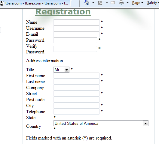

Changed country to "USA" - States field missing...
  • Posts: 10
14 years 9 months ago #31825
...until I change the country to something different, then back to USA.
I've gone into Details > Custom Fields > address_state, and there, the states are listed and default set to Alabama (1st alphabetically), however, when I go to register, the form looks like the picture below until I change the country, then change it back to USA.
Any thoughts?

First, make sure that you saved your address state field. If that still doesn't solve the problem, it means that there is a javascript error on your page:
www.hikashop.com/en/support/documentatio...ty-issues.html#modal
  • Posts: 10
14 years 9 months ago #31827
It was JQuery... i have an explicit declaration in my source code... took it out, and it solved this issue.
I don't remember why I had it there, but I'll look around and see if anything else is broken, then go from there.
Thanks.
