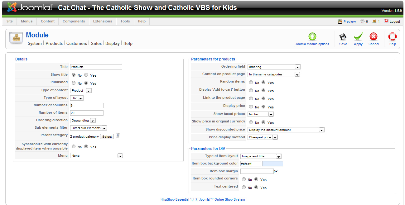

I Just added a new product to my client's store, however; the product does not show up first in the front-end. I changed the ordering of the products in their category in the backend, but that doesn't have any affect on the front-end. The ordering field in the menu options for the store is category_ordering and if I adjust the ordering of the categories, they do move around in the front-end, but the products are unaffected.
I'm using Joomla 1.5.9 and HikaShop 1.4.7

The product is in the Vacation Bible School category found here: www.catchat.ca/store/category/listing/ci...on-bible-school-kits
The product in question is called "Cat.Chat VBS #4: A Radical Ride on the Wings of Prayer – With Amazing Angels and Super Saints". The products are displayed with a content module called products (see attachment ss2.jpg). If I make changes to this module the display of the products is reflected (such as # of columns). However; when I change the ordering field or direction... nothing happens.

That's because the random option is turned on. So the system displays the products regardless of the ordering.

Thanks! That worked.
