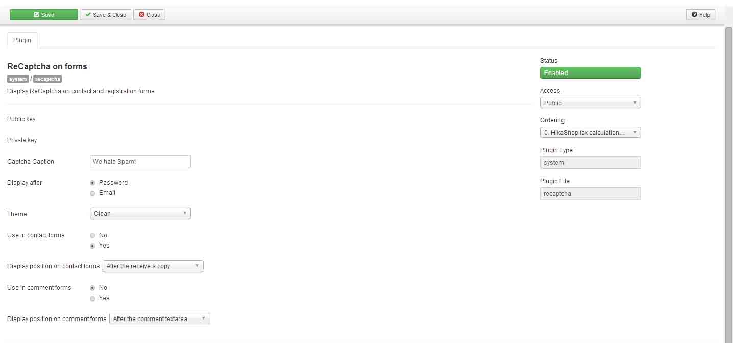

  • Posts: 16
12 years 2 months ago #163580
Here you go!
  • Posts: 86104
  • Thank you received: 14204
12 years 1 month ago #163583
This looks correct. Maybe it's because of the "use bootstrap design" option of the HikaShop configuration, or some template customization of the view. Or maybe it's simply because your Telephone custom field is not called "address_telephone" ?
Also, I see that you're not using the latest version of the ReCaptcha plugin, so I would recommend to download it again install it again, and do the code modification again in it.
The following user(s) said Thank You: eliberts
  • Posts: 16
12 years 1 month ago #163747
I was using an older version!! Thank a bunch.
