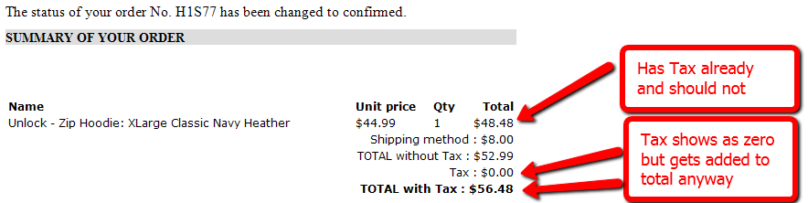

I changed the PHP in the email and now the Order is Created email is exactly right, but the Order is Confirmed email has one small problem.
It is displaying the unit price correctly and it displays the total including tax correctly, but it no longer has a line for tax in it. How do I get that back? See the ATTACHED image.

For the total column of products, you would have to change the line:
<?php echo $currencyHelper->format($item->order_product_total_price,$data->order_currency_id); ?>
to:
<?php echo $currencyHelper->format($item->order_product_total_price_no_vat,$data->order_currency_id); ?>
in your email.
If the tax line is displaying 0, it's because you changed something... I don't know what thought...
There is no tax line by default, so I don't know the code you wrote to add it.
