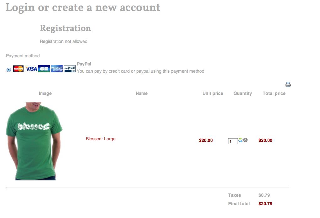

1.Checkout page goes no where, It used to go straight to the check out page, now it just stops.
I think it has something to do with the shipping address and billing address.

You deactivated the login of your checkout and you also turned off the registration in joomla. But you still have the "login" and "address" views in your HikaShop checkout workflow.
So the system still wants you to register or login but these options have be disabled so you can't. Thus, it doesn't not allow you to continue the checkout.
You shoudl change these options to solve the problem.

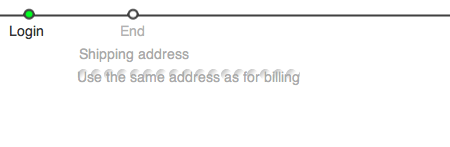

How do I remove the dots behind the words Shipping Address and make it just a simple "select button" like the billing address next to it?
heres a photo of what im talking about attached

14 years 8 months ago #33197
That comes from your template. There should be an option in your template to deactivate the style processing of checkboxes which apparently doesn't work properly here.
If you don't know where to find it, you should ask your template provider.
