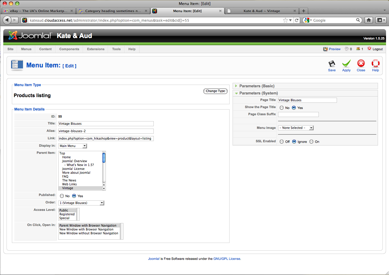

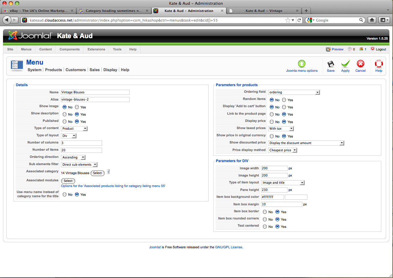

  • Posts: 13
14 years 9 months ago #32466
Have attached a couple of screeshots. Whatever I change seems to affect the page that is navigated to from the dropdown (top) menu but not the page that's brought up from clicking the link on the category list page.
  • Posts: 86179
  • Thank you received: 14216
14 years 9 months ago #32509
We only got your first screenshot.
Do you use the latest version of HikaShop ?
I recall that there were some problems with menu titles on previous versions. Maybe that would explain the problem ?

  • Posts: 13
14 years 9 months ago #32545
Hi - still a bit confused as I have only created one 'Vintage blouses' category and the options for this have the title switched on. Could you explain a bit more if there is another separate menu option and where I find this?
  • Posts: 86179
14 years 9 months ago #32582
It's the menu "vintage" kateaud.cloudaccess.net/vintage.html "show the page title" option which should be turned on.
As I said, the menu "Vintage blouses"'s title is displayed properly here kateaud.cloudaccess.net/vintage/vintage-blouses.html
You're not looking at the options of the correct menu, that's why.

14 years 9 months ago #32663
You see 'Vintage' instead of 'Vintage Blouses' because in the hikashop options of your 'Vintage' menu, you didn't change the option "Use menu name instead of category name for the title".
On the page kateaud.cloudaccess.net/accessories/cate...-pocket-watches.html it's the module with the id 60 which displays your products so you should change the centering option of that module in its HikaShop options.
