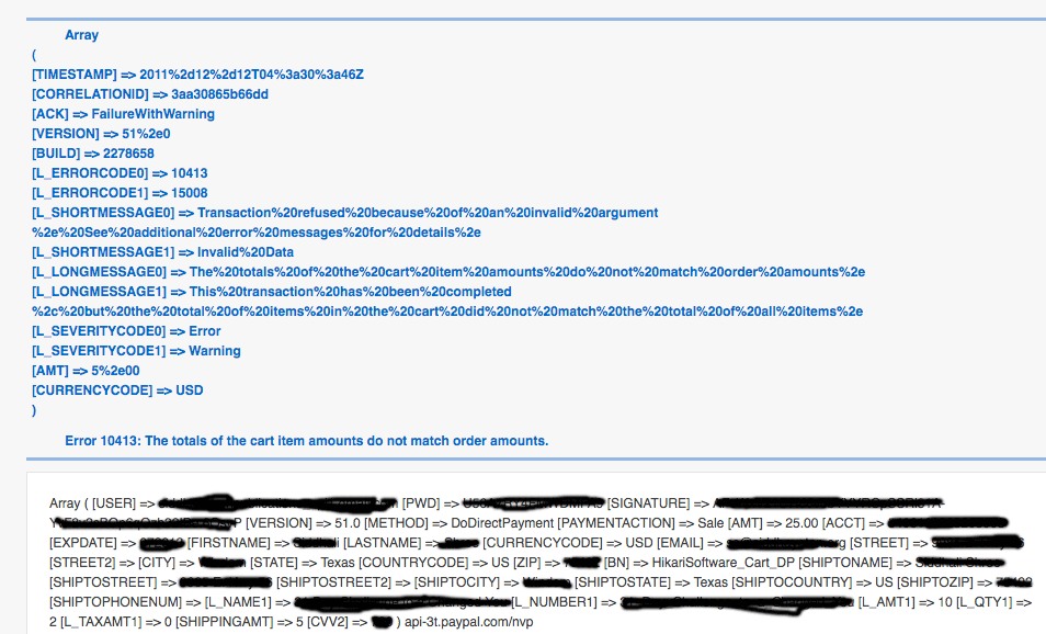

Something is wrong with paypal pro. Please see attached screenshot.
I've setup all my zones correctly, my taxes are all 0 or 0%, and when I use paypal standard the amounts are correct (both product amount + shipping = correct total); when I use paypal standard pro, i get the follow errors. I turned on debug mode to show you what is happening. I hope you can help, because I really like your product and plan to upgrade.
I am located in the United States, so I'm not sure what's happening. :)
Thanks again!
Array
[TIMESTAMP] => 2011%2d12%2d12T05%3a06%3a53Z
[CORRELATIONID] => b748f15fb89fa
[ACK] => FailureWithWarning
[VERSION] => 51%2e0
[BUILD] => 2278658
[L_ERRORCODE0] => 10413
[L_ERRORCODE1] => 15008
[L_SHORTMESSAGE0] => Transaction%20refused%20because%20of%20an%20invalid%20argument%2e%20See%20additional%20error%20messages%20for%20details%2e
[L_SHORTMESSAGE1] => Invalid%20Data
[L_LONGMESSAGE0] => The%20totals%20of%20the%20cart%20item%20amounts%20do%20not%20match%20order%20amounts%2e
[L_LONGMESSAGE1] => This%20transaction%20has%20been%20completed%2c%20but%20the%20total%20of%20items%20in%20the%20cart%20did%20not%20match%20the%20total%20of%20all%20items%2e
[L_SEVERITYCODE0] => Error
[L_SEVERITYCODE1] => Warning
[AMT] => 5%2e00
[CURRENCYCODE] => USD
Error 10413: The totals of the cart item amounts do not match order amounts.
(If debug mode isn't on, only this line shows)
Thanks!

Please try to add the line:
$vars=$vars-(@$vars+@$vars);
before the code:
if( $method->payment_params->ask_ccv ) {
$vars = $this->cc_CCV;
in the file plugins/hikashoppayment/paypalpro.php and try again.
That should help avoid the problem.

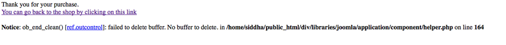

With a successful order, I encountered another tiny issue: I was lead to the "thank you page" that I created; however, in between this process I encountered the following:
CART process: Order goes through successfully >> goes to a temporary thank you page with an error (see below) >> then it gets redirected to the page I created.
How can I skip this middle step or at least remove the error:
Thanks again!!
  • Posts: 86177
  • Thank you received: 14212
14 years 9 months ago #32515
Yes, it will be in next release.
For that error message, it comes from Joomla so hard to say how that could be fixed.
One thing though. That error message is just a notice which shouldn't be displayed on a production server as the error reporting should be turned off (in the configuration of joomla 1.7, or in your php.ini for joomla 1.5).
