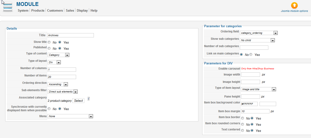

I went into Content Modules and created a new module. I attached a screen shot of the setup. Is this where I'm going wrong at?
  • Posts: 86179
  • Thank you received: 14216
14 years 9 months ago #32780
Why are you creating a new module ? I told you that you should edit the existing modules and change the "Link to the product page" there, not to create a new module.
