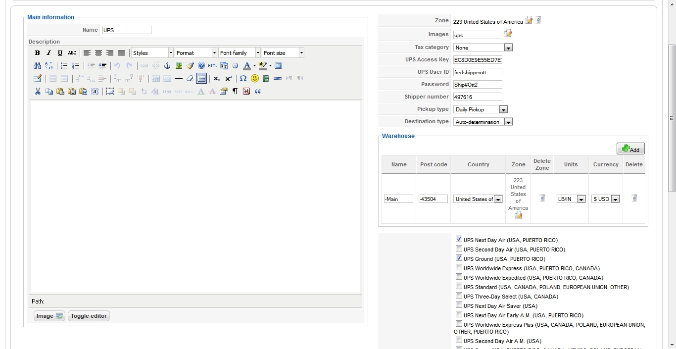

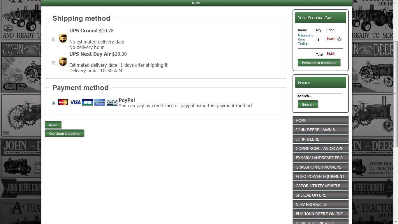

My Payment Methods were working fine - they were displayed together with in the checkout string "shipping_payment". While using "firebug" and trying to fix a display problem with the shipping methods layout the payment method disappeared and now I get the error message "no payment methods found - please configue a payment method". My question: Is it possible I messed up the plugin - I have read FAQ - double checked shipping & payment methods & zones - suppose to go "live" today - please help.

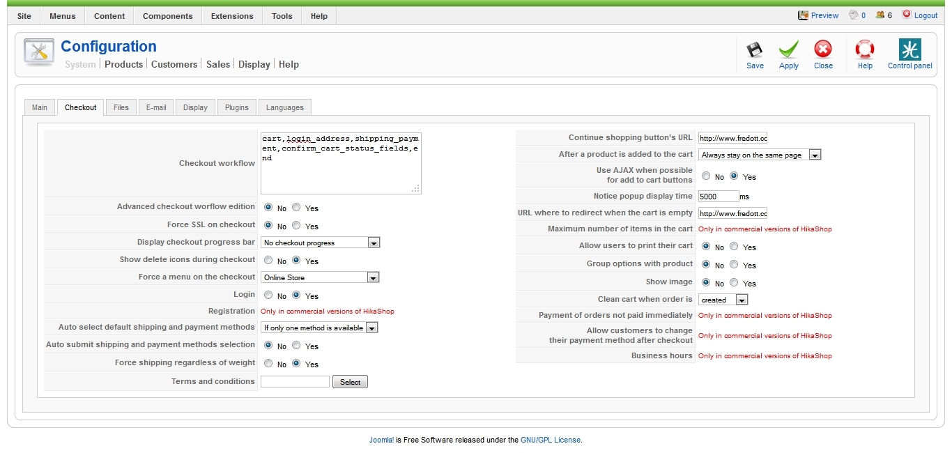

www.hikashop.com/en/support/documentatio...ins-listing.html#faq

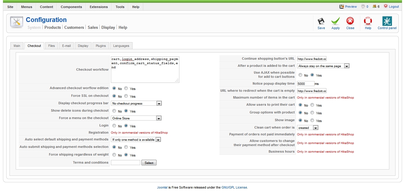

If you didn't find which cause it was, please do a screenshot of your payment plugin's options and the Checkout tab of your HikaShop configuration so that we can see what you did.

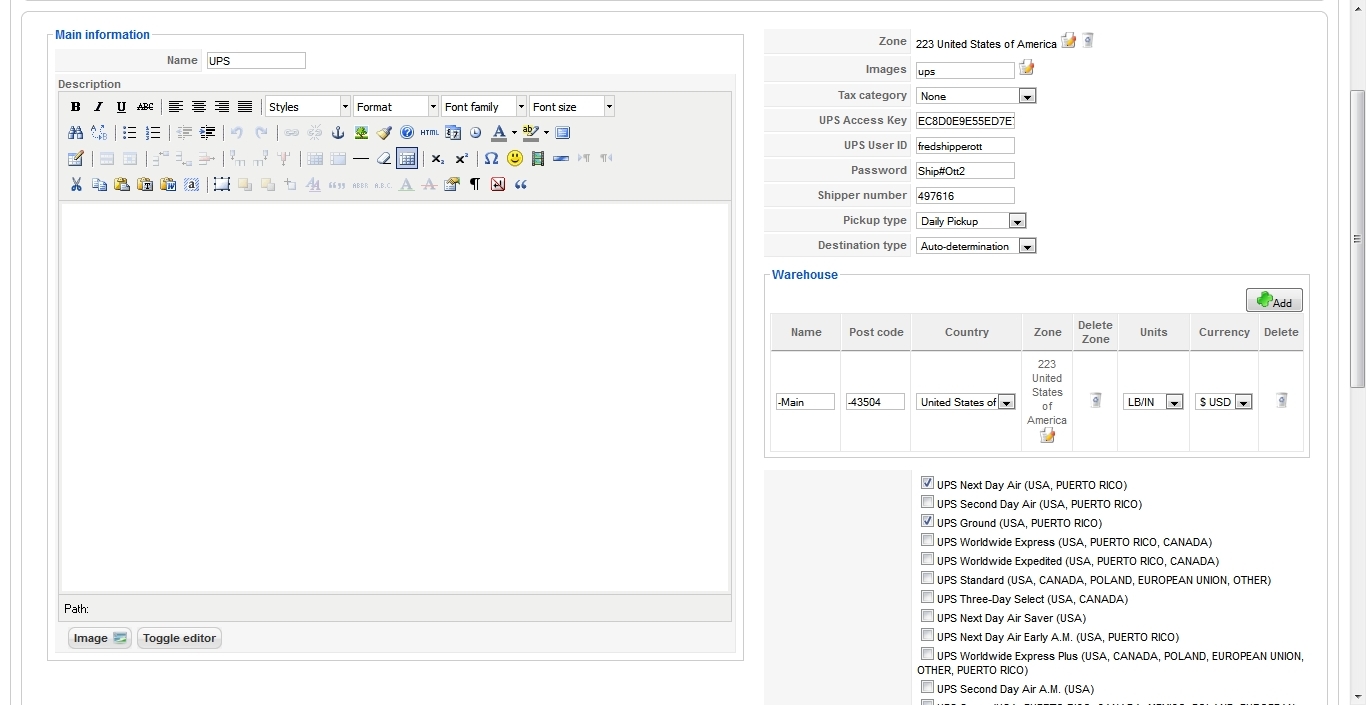

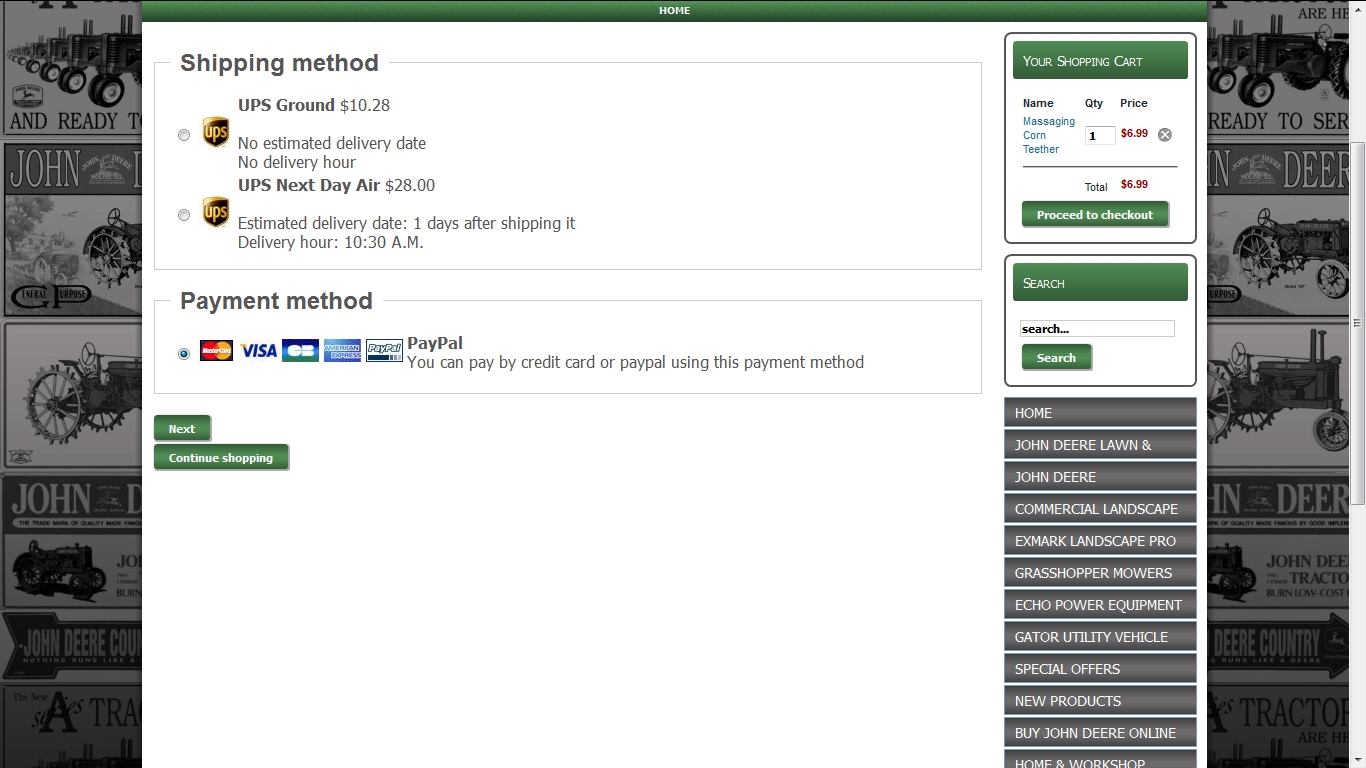

Oops - prematurely hit submit on my last. I can get the payment method to show only if I have more than one "shipping method" available (such as UPS ground & air) I've tried every combo of "Auto select, Auto submit, & shipping_payment vs shipping,payment.

You didn't do a screenshot of the most important screen: the paypal plugin's option screen.
I suspect that it comes from this place.
I would say that you selected a shipping method restriction. You should make sure that you unselect the shipping methods selected there and save.
