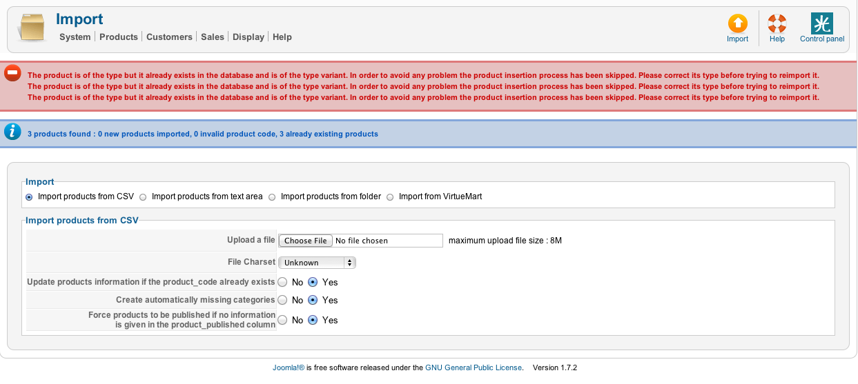

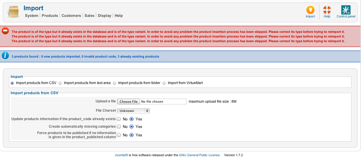

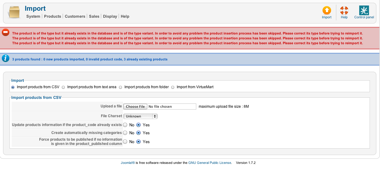

  • Posts: 21
14 years 8 months ago #33467
Hi, yes the images are in the correct folder.
This is the error message I get when importing:
The product is of the type but it already exists in the database and is of the type variant. In order to avoid any problem the product insertion process has been skipped. Please correct its type before trying to reimport it.
3 products found : 0 new products imported, 0 invalid product code, 3 already existing products
Please see attached image and files with screenshots of variants etc
  • Posts: 86179
  • Thank you received: 14216
14 years 8 months ago #33493
Ah yes, as it's for variants, you should add the product_type column like that:
product_code,files,product_type
my_prod1,myfile1.avi,variant
my_prod2,myfile2.avi,variant
