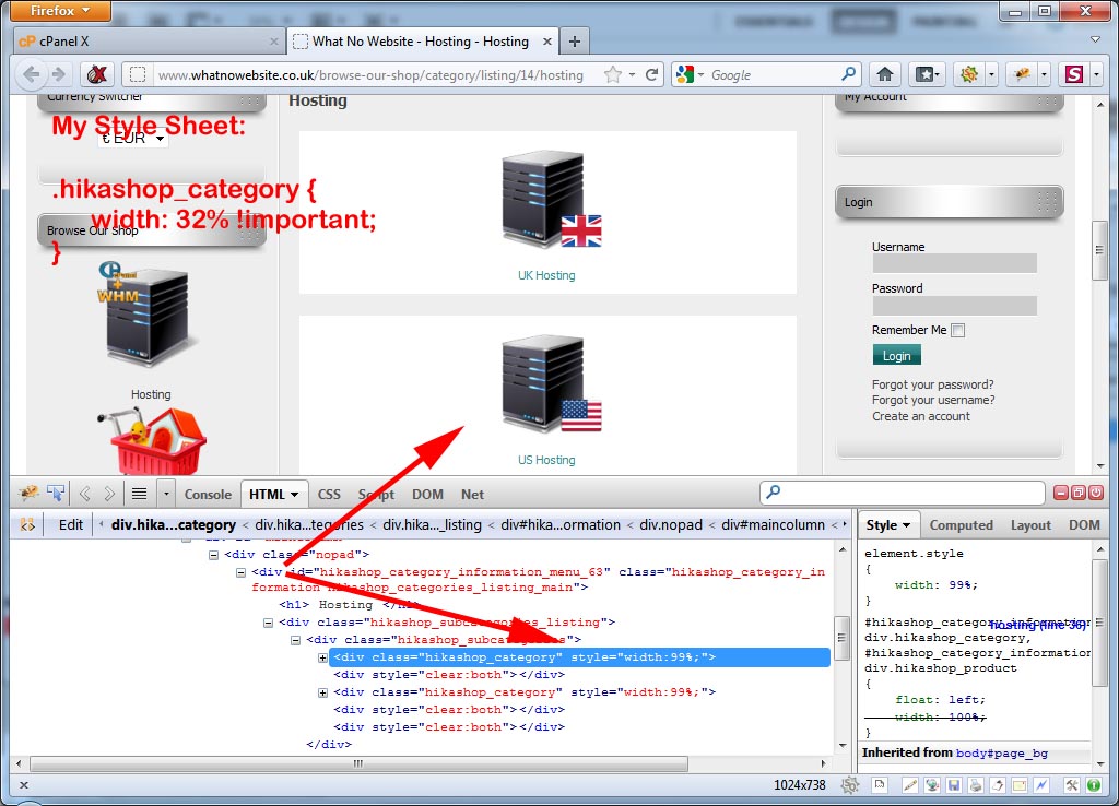

I'm having fun here. I particularly like the way you are using DIVs and not tables for layout and I "think" I've cracked your modules and how to customise the display and layout for each. However, I'm havinga little trouble with customising stuff.
I've attached an image. it appears as though my own style sheet isn't even being loaded. I checked in FF and Chrome.

14 years 8 months ago #33629
I can see that you're still using the frontend_default.css of HikaShop which means that your modification wasn't taken into account. Please make sure that in the front end CSS option of the Display tab of the configuration of HikaShop you have selected your custom CSS.
Also, if you want to increase the number of columns, you shouldn't do it with CSS but by changing the number of columns option of your menu.
