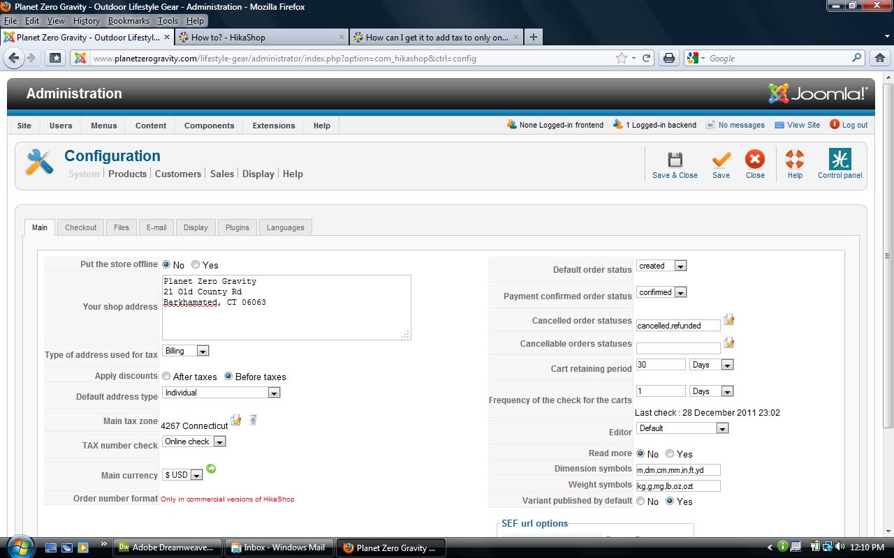

I am also experiencing the same tax problem as HC007 mentions above, except you can see the tax added already in the order completion page before going to the payment processor (Paypal in my case). I am only able so far to have people checkout with either no tax at all added to their order, or tax added no matter which state they register with. I would only like to charge 6.35% tax to CT residents.
Our website is planetzerogravity.com/lifestyle-gear. Here is what I have done to set up the taxes. Please let me know if I have missed something. Attached are some screen shots.

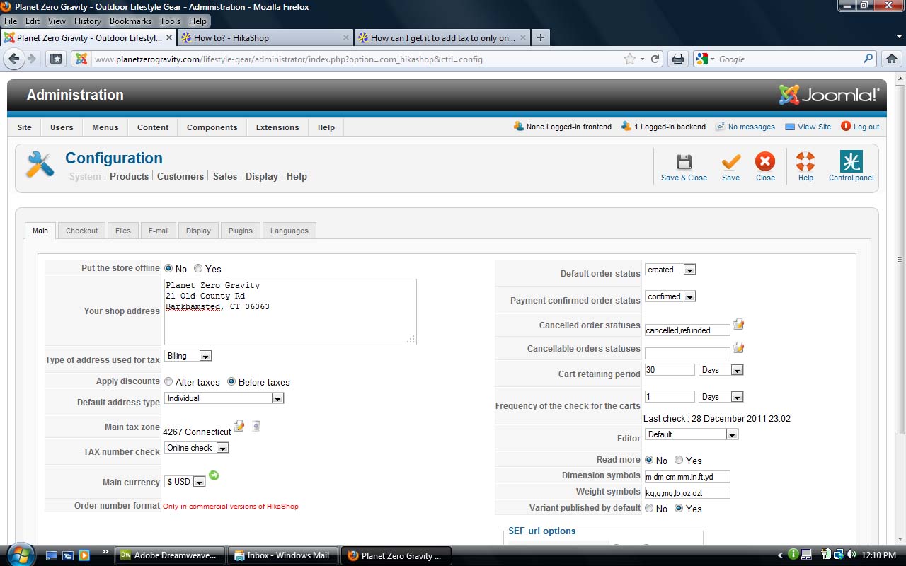

1)Under configuration page - main : set main tax zone to 4267 Connecticut
2)Under Manage Tax Categories : created 'sales tax'
3)Under Manage Rates : created tax namekey 'CT Tax' and set rate to 6.35%
4)Under zones : filled in the information for CT and selected published

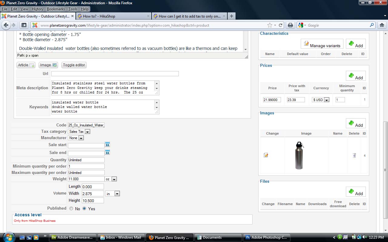

5)In my product pages under tax category: I select the 'sales tax' I created

you don't have to create/modify any zones. The zones by default should be used as there is already a Connecticut zone, and that's the one which should be used everywhere.
Also, you didn't say that you created a new tax rules on the System->Taxation menu. Tax rules are what link zones, tax categories and tax rates together. If you don't have one, no tax will be added to the prices. Also, that's an important part of the tax setup so could you do a screenshot of that ?
