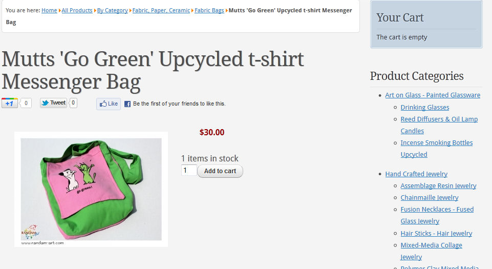

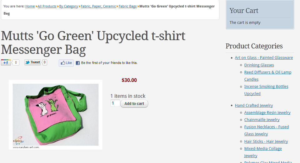

I can't figure out what is wrong or how to fix this. If I give the product a stock value, it works fine.
This is the correct layout:
If the item is out of stock, the right side modules drop to below the main area. This is obviously not acceptable. I did not change any code in the views, and I have read everything I can to try and solve this, but I don't see an answer.
