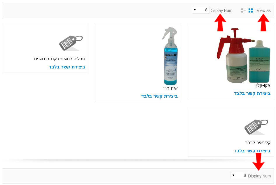

I'm using Joomla! 3.3.1 with Hikashop essential and I', looking to translate both "View as:" and "Display Num" in products pagination. Looked all over for the translation file could not locate it. I've checked en-GB.com_hikashop.ini, en-GB.ini and more with no luck. Can you please tell me where can I locate this two?
Thank you in advance,
Guy.

11 years 11 months ago #164791
Hello Nicolas and thank you for your replay.
I've made an attempt to use the override tool but all search results for "View as:" and "Display Num" came up empty. As I've mentioned, I looked at the en-GB.ini file and couldn't find this titles as well. Could it be that they are hard coded?
Guy.

11 years 10 months ago #167820
Hi Mohamed,
Thank you for your help but the field you've sent me is already translated in my language files and that's not the one :S
I'm talking about two fields:
Display Num
View as
I've searched all over, in the en-GB.ini file, in en-GB.com_hikashop,ini and even tried Joomla's core language system but could not find this fields ANYWHERE!!!
Could it be that they are hard coded the wrong way? If so, where should I look for the PHP files?
See attached image for the missing translations.
Guy.

11 years 10 months ago #169051
Sorry, it didn't work either.
I've tried to enable the language debugging in global configurations:
I get **words** when I've got a value with translation and ??word?? when there's no translation.
Display num got ?? -> ??Display Num??
View as got nothing around it so that supports my first thought that it might be hard coded without JText.
UPDATE!!!!
Found it, it was a template override!!! Found it after a long search.
Thank you for your help.
