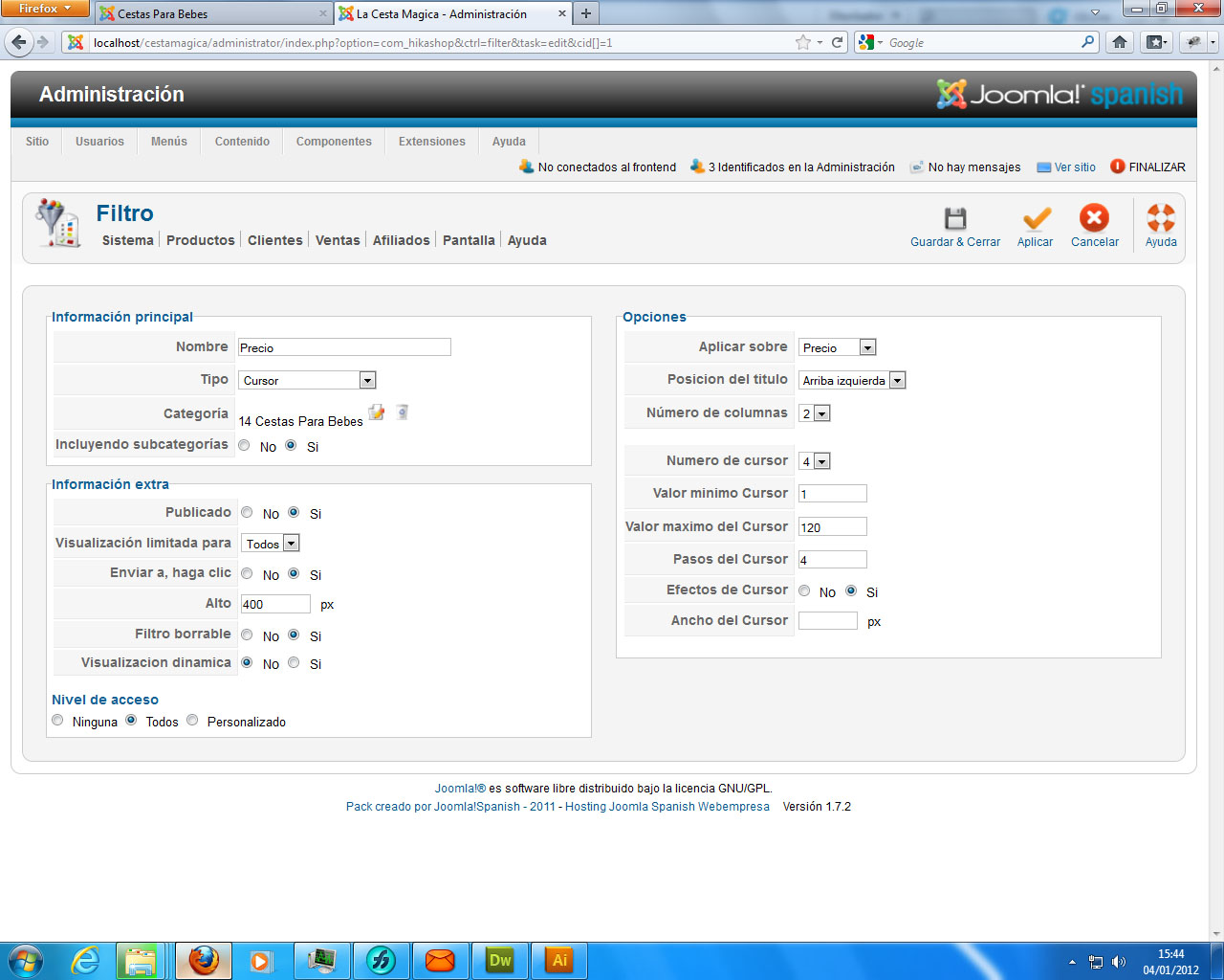

  • Posts: 441
  • Thank you received: 24
14 years 8 months ago #34397

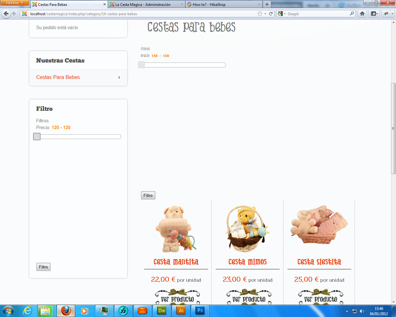

This is what i get with this configuration

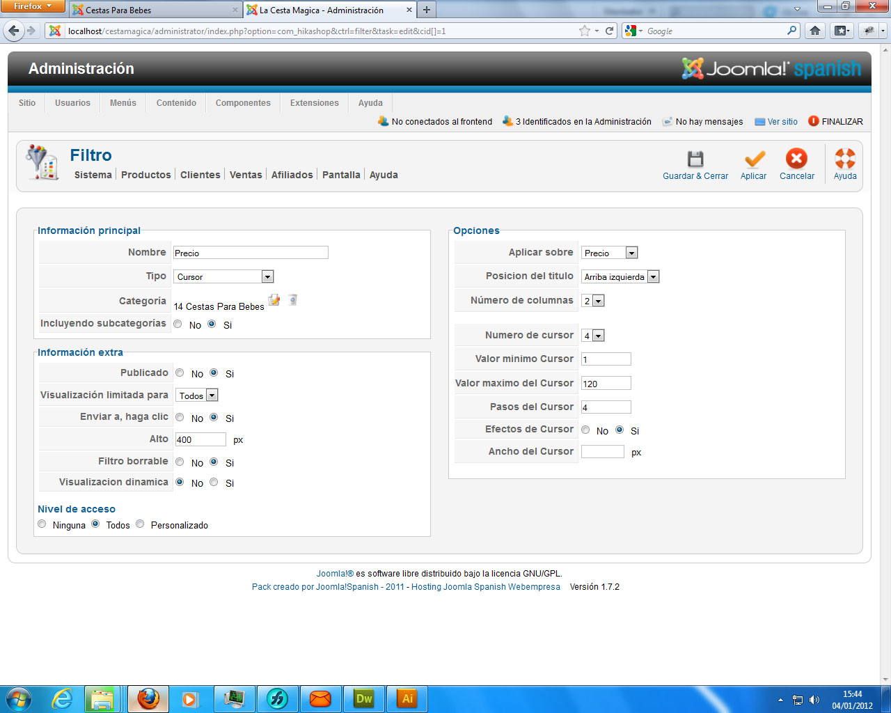

  • Posts: 441
14 years 8 months ago #34398

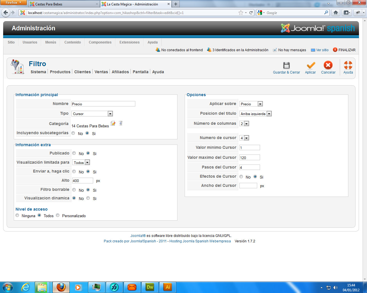

and this is the configuration
  • Posts: 86104
  • Thank you received: 14203
14 years 8 months ago #34458
Thank you. We were able to reproduce the problem.
Please add the code:
if($minVal>$maxVal){
$tmp = $maxVal;
$maxVal = $minVal;
$minVal = $tmp;
if($cursorMin>$cursorMax){
$tmp = $cursorMax;
$cursorMax = $cursorMin;
$cursorMin = $tmp;
just before the code:
$js='jQuery(document).ready(function(){
jQuery("#slider_'.$filter->filter_namekey.'_'.$divName.'").removeAttr("slide").slider({
in the file administrator/components/com_hikashop/classes/filter.php and it will work.
We'll add that fix to next version of HikaShop too.

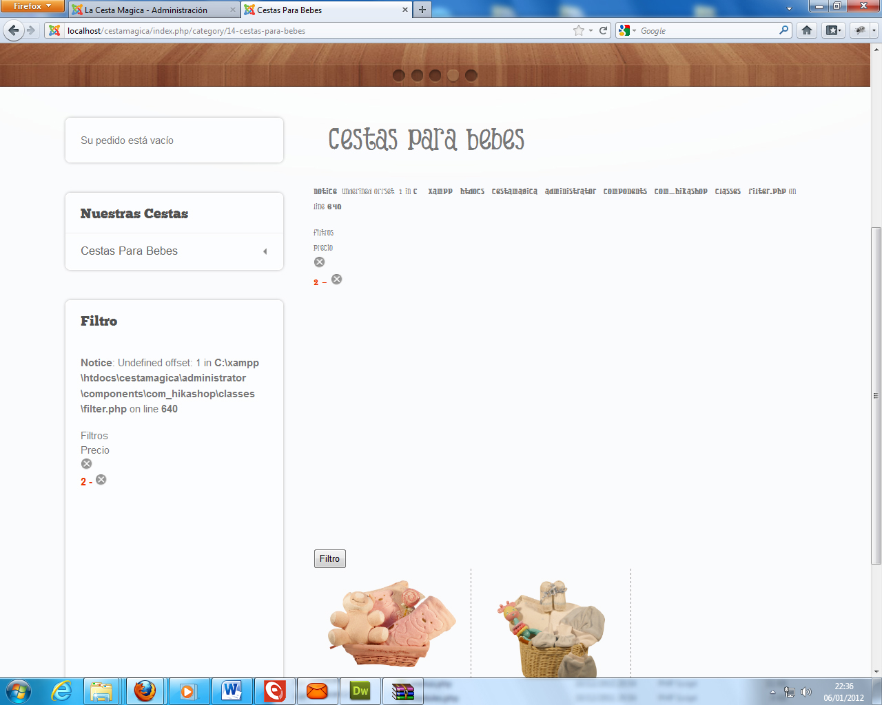

the filter continues without working properly, next fail:

Mmm. We don't have these errors on our end. Could you put online your website and provide an FTP access to it so that we can have a look at the problem and fix what needs to be fixed ?
