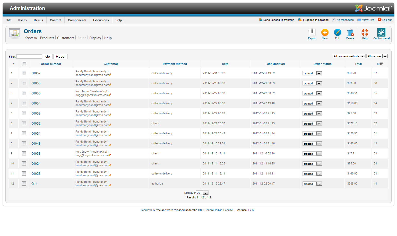

I use HikaShop for wholesale orders. Our sales person enters orders for all our sales. He is listed as the customer for all the orders in the backend under "Customer". Is there a way to replace the "customer" field with the billing company field instead?

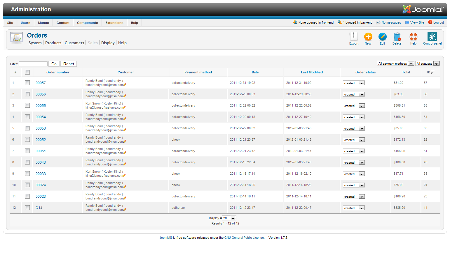

I followed your instructions, but it did not change the field. I still see "customer" listed in the back menu. Please see attached image. Instead of customer, I need the name of the company that is billed. I do not know anything about PHP, but your code referenced first name and last name, which is not what I need.

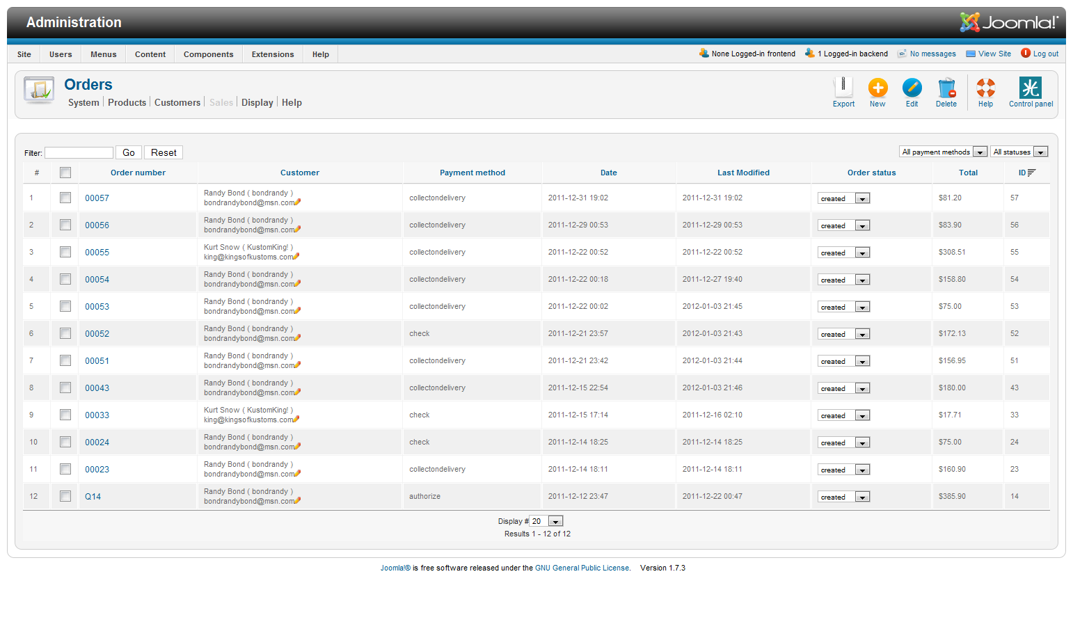

Which field are you talking about ? Are you sure that you edited the correct file ?
Could you do a screenshot ? The screenshot you attached to your message doesn't seem to be the correct one.

Sorry about hta, I did not uplaod the wrong image file. Here is the correct one.

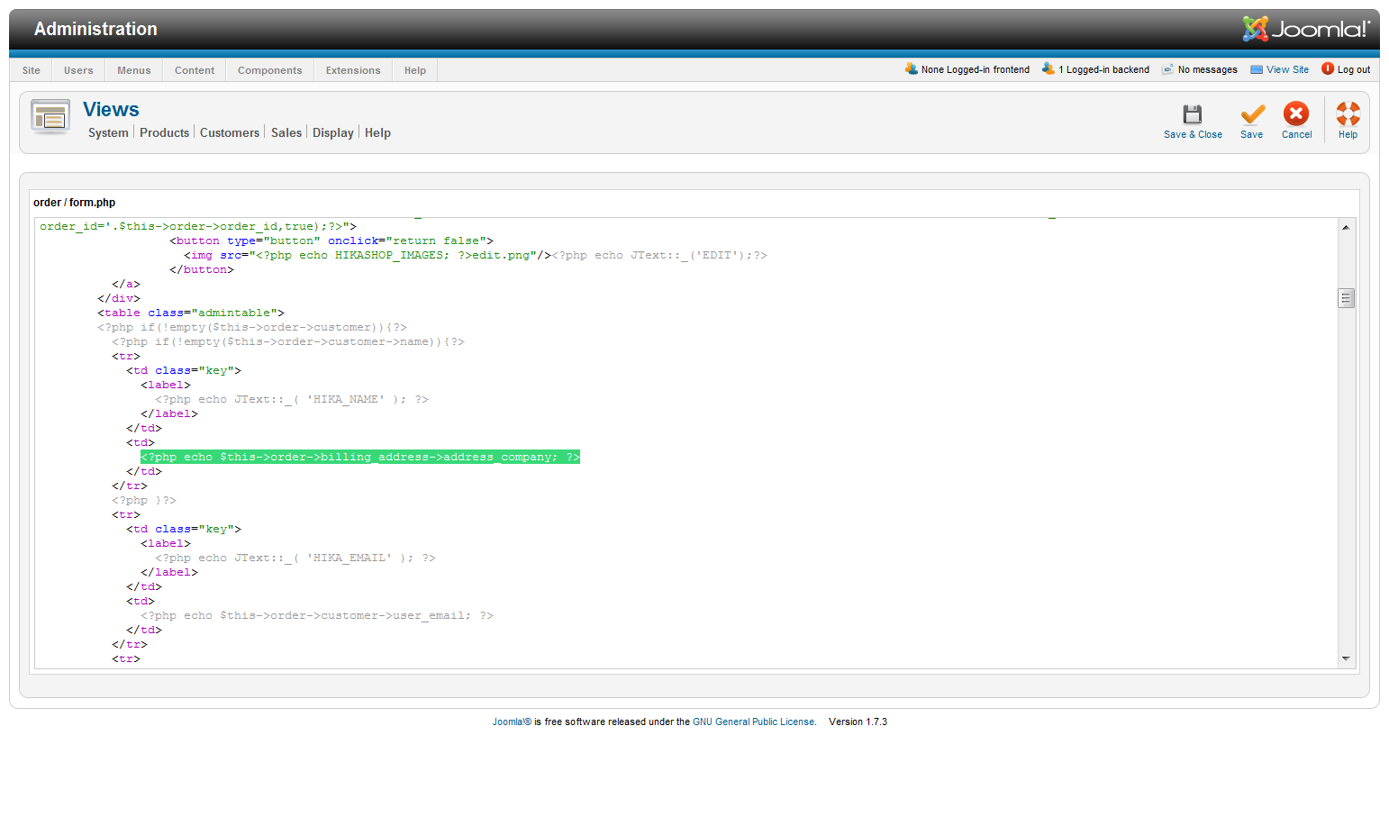

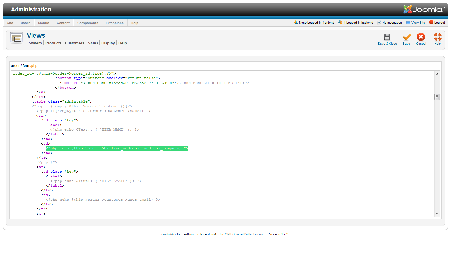

Also, here is a screenshot of where I placed the code.

Ah now I see.
I thought that you were talking about the customer information on the order details page.
For the orders listing, it's more difficult to do as that information is not loaded on the listing.
You would have to first load it with a MySQL query and then you would be able to display the address company.
You can do that in the file "listing" of the view "order" of the back end via the menu Display->Views
