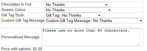

  • Posts: 121
  • Hikashop Essential
14 years 8 months ago #34613
Actually, I just noticed something with some tests I was running.
EVERY option gets added to the cart whether you want it or not? Like the image above, if I have a choice of no thanks and 0 cost, that means, don't want to add that to the card, the system is adding x number like everything else for free.
Is that "fixable?"
Cheers
  • Posts: 86179
  • Thank you received: 14214
14 years 8 months ago #34652
For the spacing and other styling, you can add your CSS code in the front end CSS file of HikaShop that you can edit via the Display tab of the configuration.
Indeed, the option is added regardless of its price. However, you should see they options below the product name on the cart and that should confuse users. If you see the options in the cart as regular products, that's because either you're using an old version of HikaShop or the option "Group options with product" of the Checkout tab of the configuration is turned off.
If you really do not want to see the option selection at all, you will have to edit the file "cart" of the view "checkout" via the menu Display->Views to hide the options if they don't have a price.
