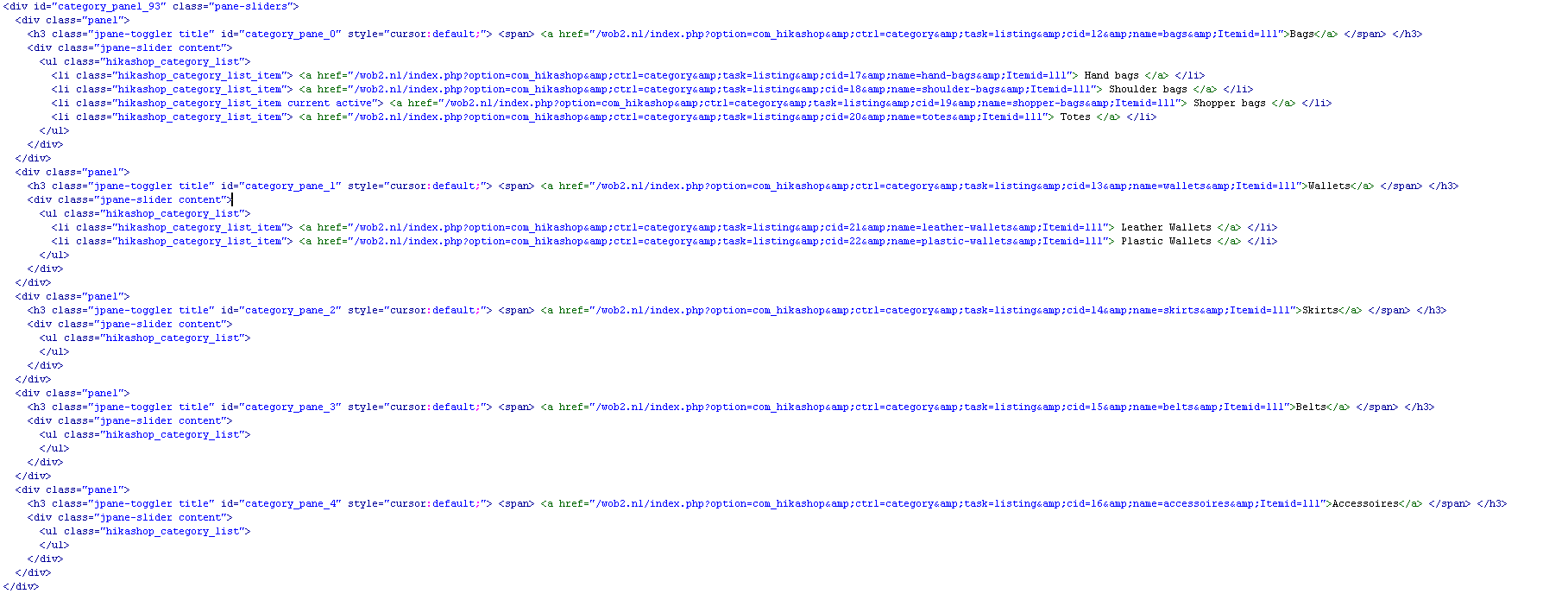

How can I create a simple ul li structure with active item/parent classes for the categories?
See attachment:

You can do that by creating a new hikashop module (via the joomla module manager) and then setting the hikashop options so that the layout used is the list one and turn on the "Show sub categories" option there.

With Show sub categories: "All sub categories"
There is no parent active class... am I right?

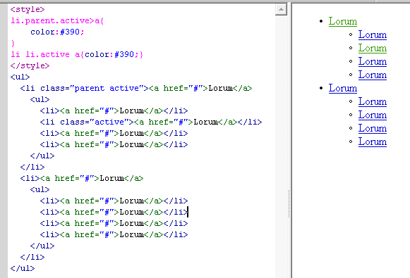

  • Posts: 38
14 years 8 months ago #34731
I just (5 min ago) downloaded the latest version of Hikashop and installed it over the current version.
Still I have this category listing, without a parent class active.
See attachment:
COBIZ webdevelopment | www.cobiz.nl
