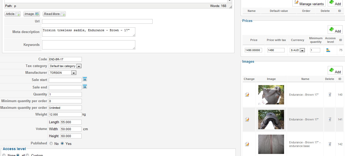

All saddles are set to 12 kg and cost more than $500

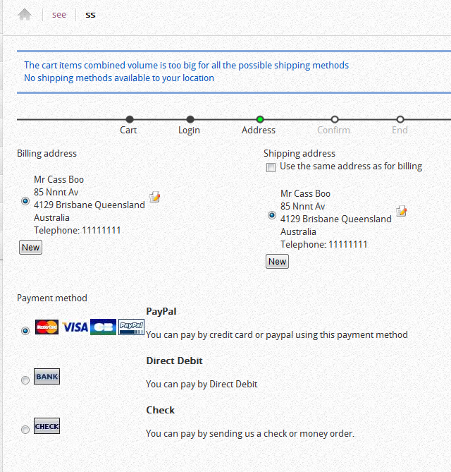

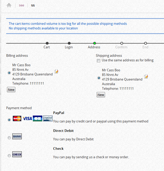

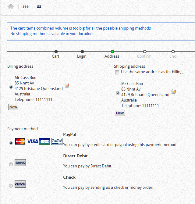

This is the message I receive at the checkout:
"The cart items combined volume is too big for all the possible shipping methods
No shipping methods available to your location"

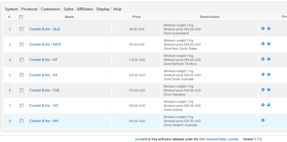

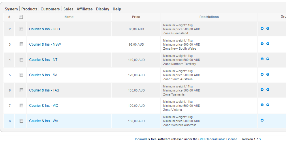

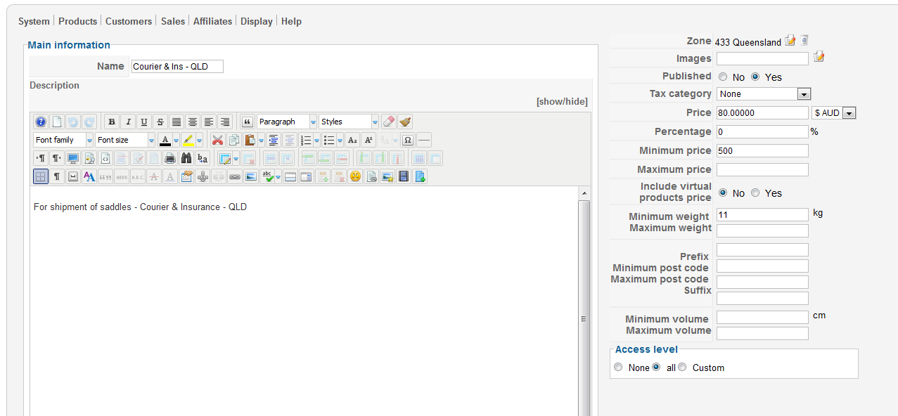

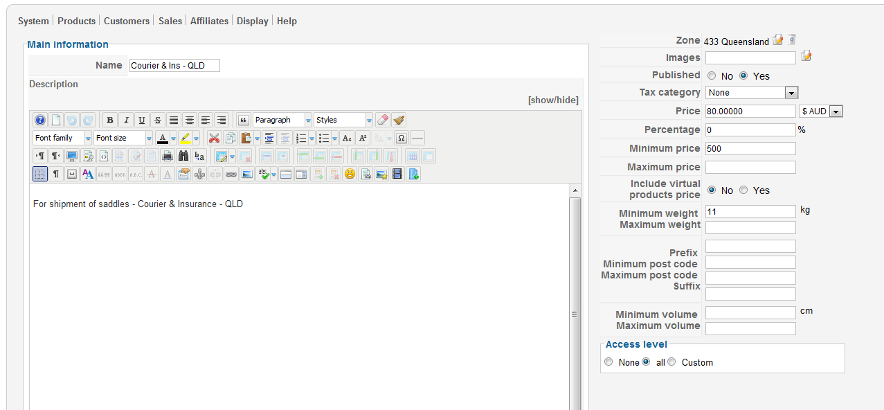

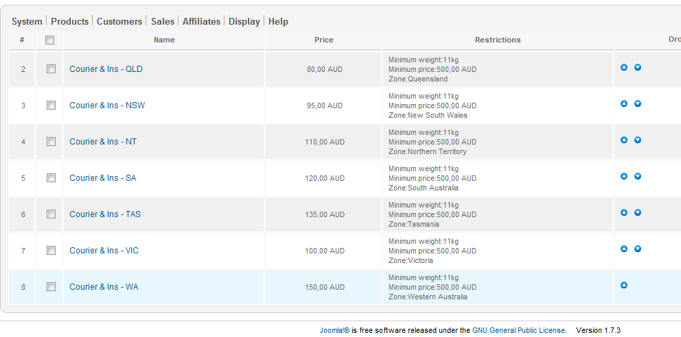

Here is a screenshot of the manual shipping methods:

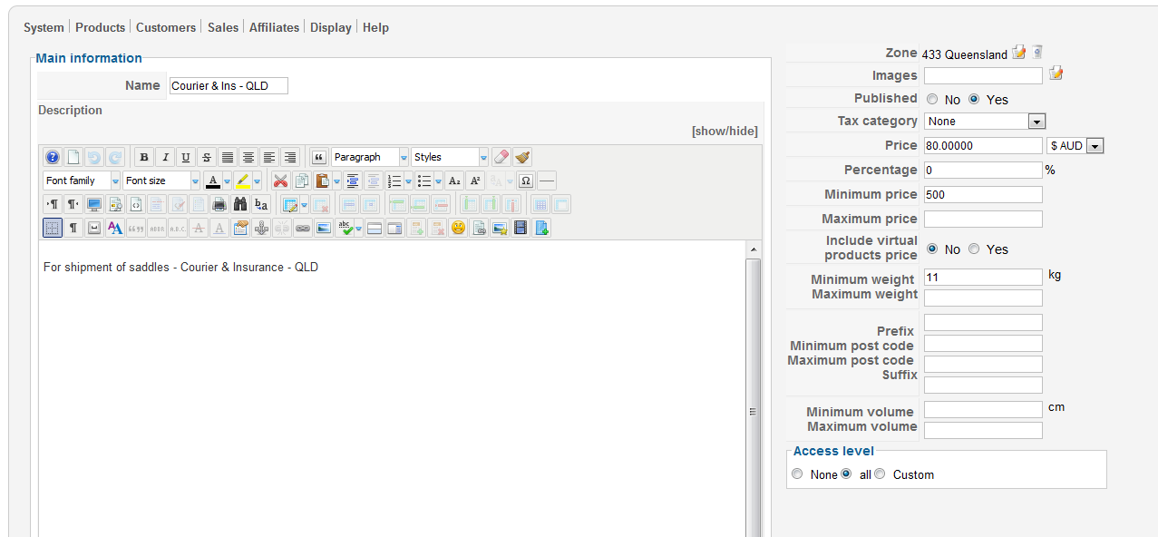

One of the methods:
Setup for a saddle:
It seems that once the Australia Post plugin finds out it cannot be shipped by post, the system doesn't use the manual shipping method.
Here is a screenshot of the checkout. The address is for QLD so it should work
