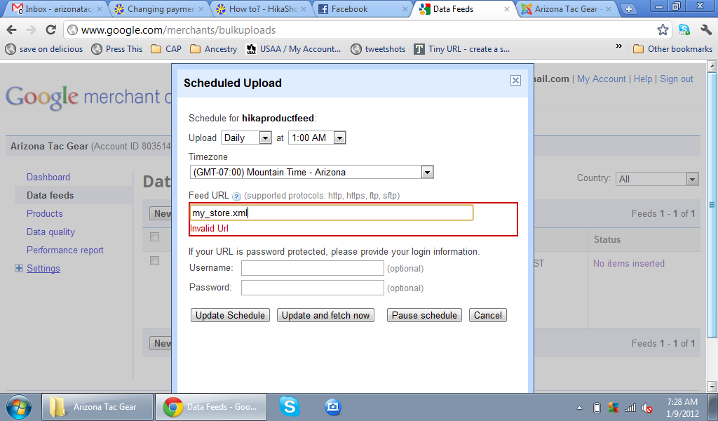

I'm following the documentation on setting up Google Products automatically using the Cron, and the Google merchant center is asking for a feed url. The documentation talks about naming an xml file. Which feed do I need to give to Google?
  • Posts: 86179
  • Thank you received: 14214
14 years 8 months ago #34872
In your Google products account, you need to enter a feed name. That name will have to be the same in the plugin.
Here is the documentation page of Google, in order to setup your account on their end:
support.google.com/merchants/bin/answer.py?hl=en&answer=188475

  • Posts: 46
14 years 8 months ago #34932
Google is asking for a feed url, with an http://.
  • Posts: 86179
14 years 8 months ago #34933
You should not create a scheduled upload.

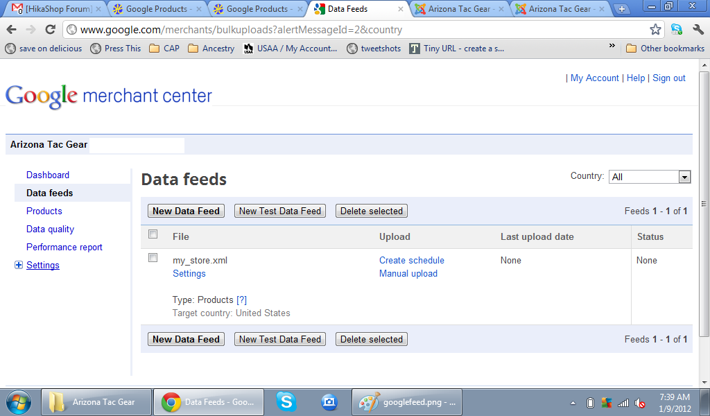

Just close that popup. There, on that listing, under the "File" column you should have the name of your data feed.
  • Posts: 46
14 years 8 months ago #34935
So I just started from scratch, and put in your example (my_store.xml, which matches the name I put in Google).
