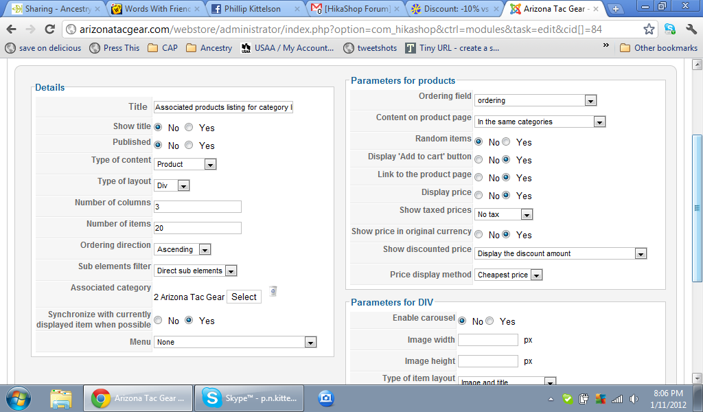

  • Posts: 46
14 years 8 months ago #35270
picture of content modual 84.
  • Posts: 86179
  • Thank you received: 14214
14 years 8 months ago #35296
As I said, you need to change the option for the discounted price in that module.
You set it to "display the discount amount" so it's displaying the discount value which is 10%. If you set it to "Display the price before the discount" it will do what you want.
  • Posts: 46
14 years 8 months ago #35308
Ah, I misinterpreted it as changing the display without tax option.
